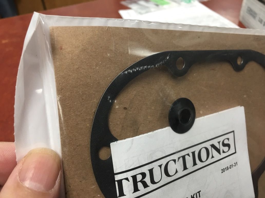

Has anyone removed the Slinger?
Is it just a cap or is the nut and cap one piece?
If it's just a cap it would seem removable. if it's one piece then you will need to purchase a new nut as I doubt the dealership would return the old one at the time in install.
I have seen several reports that the Slinger made the problem worst.

I had the "oil slinger" installed on my bike in early July. It made my transfer significantly worse.
Without the oil slinger, 4 ounces every 1,000 miles.
With oil slinger, 10+ ounces every 300 miles.
I had my dealer remove the slinger, and back to about 4 ounces every 1,000 miles.
The oil slinger can be removed, it is not part of the nut.
Here is an actual photograph of the "kit" - the plastic slinger and a new gasket.
