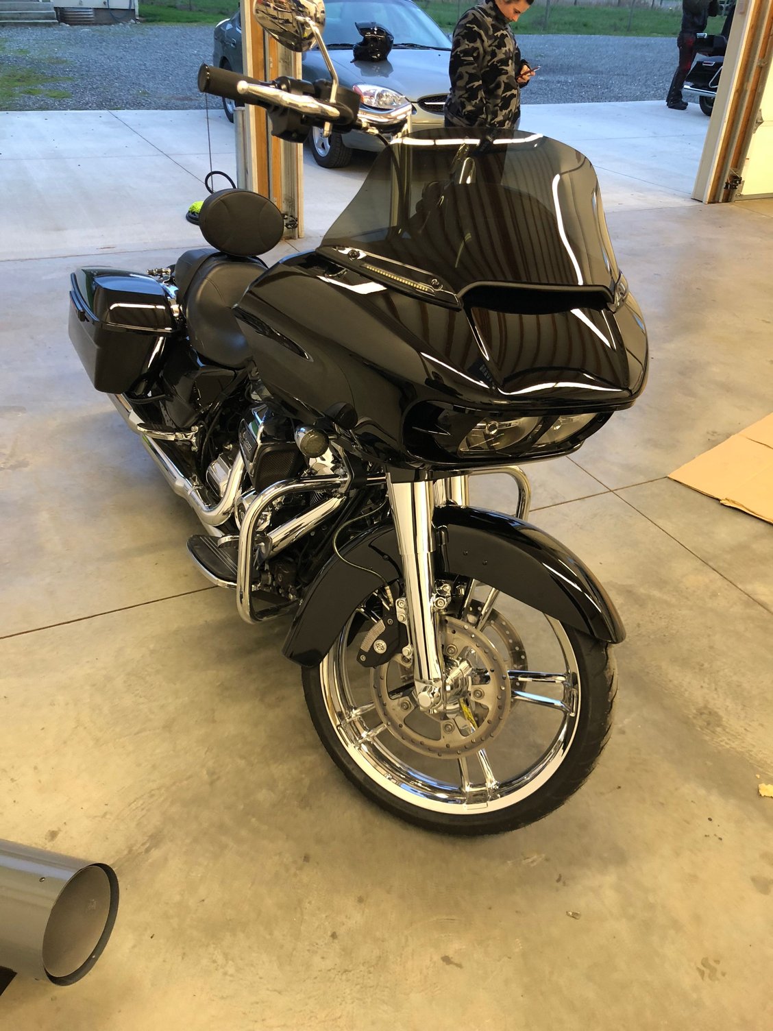

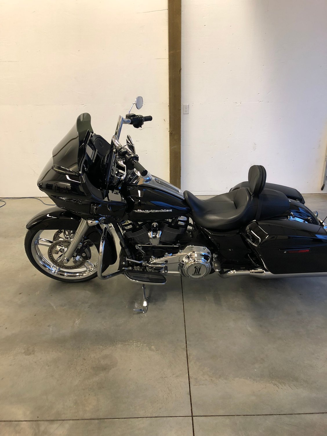

I need to get pictures posted up, but I got it all done about a week ago. Chrome sliders with a 21 in enforcer. I ended up doing it myself, pretty simple forks to do. I used progressive lowering springs and screamin eagle heavy fork oil and I really like how the fork feels now. It rides better than stock. The stock Showa fork has a short spring and about a 4-6 inch long preload spacer, where the progressive uses a long spring and .5 inch preload spacer. I don’t think monotubes would be much better, if at all. It certainly shines compared to the shocks that’s for sure. If I ever decide to upgrade anything the shocks will go but I’ll probably leave the fork alone.

Love that color! How do you like your thunder header? I did a 1 inch drop on mine and it still sits a smidge higher than stock. I read kinda mixed reviews on lowering with a 21 vs not lowering with a 21 and decided to just lower it since the springs were only about 100 bucks.

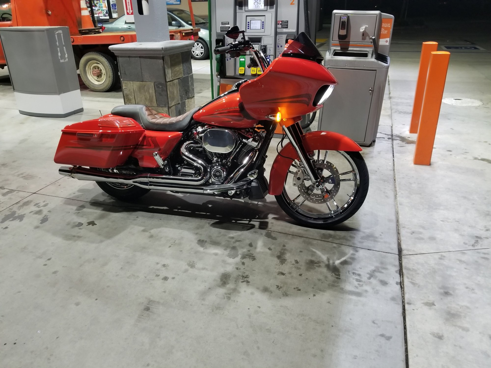

21 front and 18 on the rear, thought about lowering it but with the wide foot boards I put on I kinda like the extra ground clearance for spirited riding, paid too much for them to be dragging!
