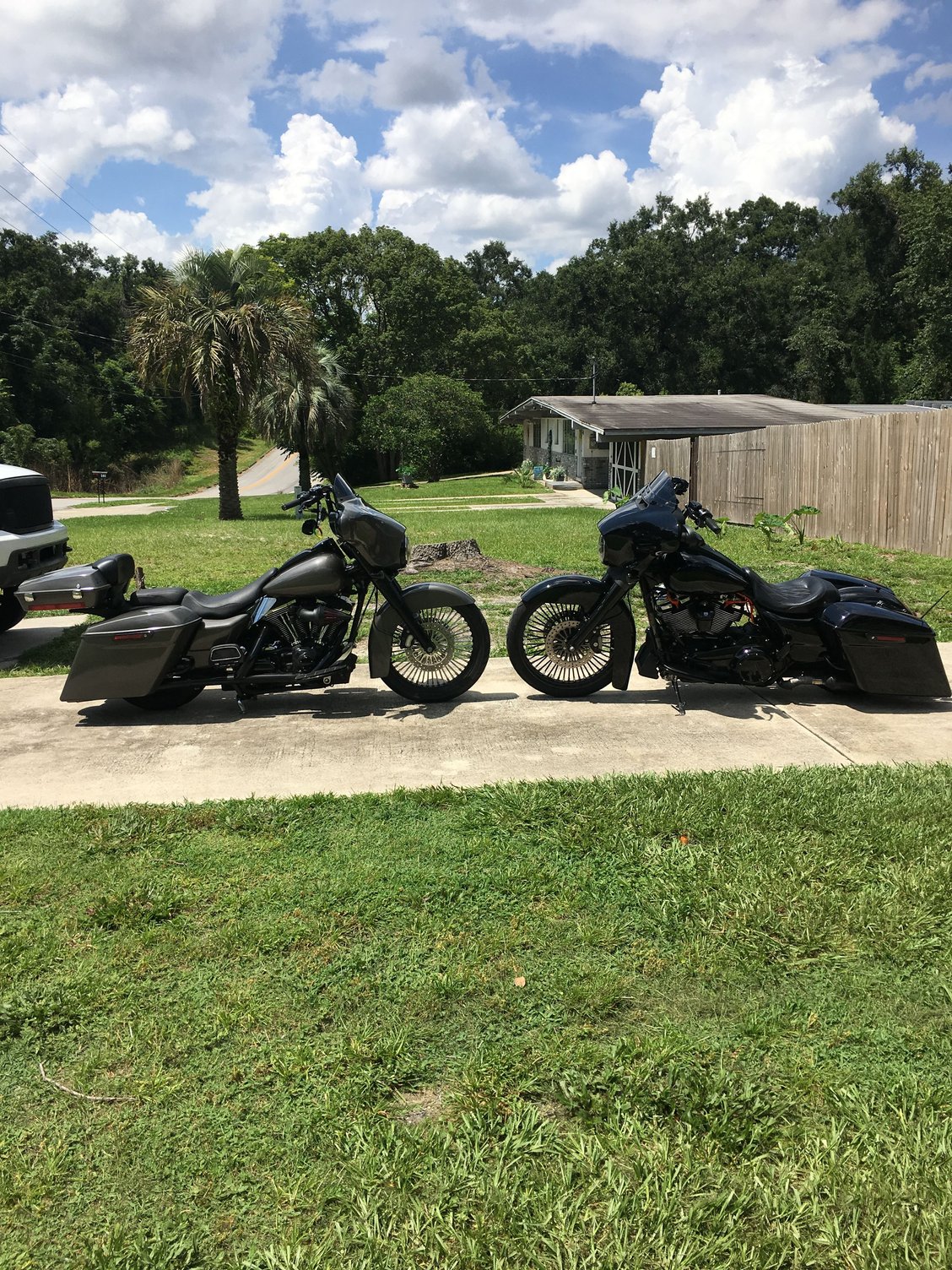

Been lurking on the forum for a couple weeks now so I figured I would make my first post. Names Ryan and I’m from central Florida, 2017 street glide build in process. 6300 miles, tts , 475 cam, stainless 2-1 built by me, head work and s/e valve springs, adj push rods, s/e lifters , s/e injectors, 4.125 bore and in the process of searching for a clutch and breather set up.
