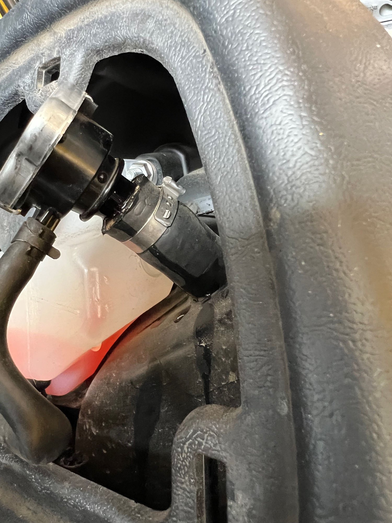

2017 Ultra Limited, FLHTK, Milwaukee 8 at 17400 miles - Check Engine Light and Engine Coolant Temperature Light came on. Fault Code for ECM - P1019 (Engine Coolant Temperature Sensor) and Pn 001351-01. On a 45 degree day I rode the bike a mile and found coolant leaking from the hose connection just below the filler cap. I could easily turn the plastic connector the coolant cap is attached to, inside the hose. The coolant hose clamp is not holding and coolant is leaking out.
2017 M8 Coolant Leak below cap at Hose Connection

Had a leak on my 21 RGL after about 7k miles, was at the filler cap hose at the cap and radiator as the clamps were very loose. I repaired my own with a couple screw clamps and a piece of hose from the local NAPA store.
