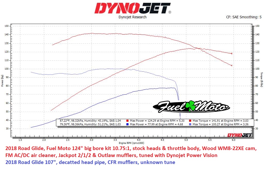

2018 Road Glide with our $2799.00 turn key special which includes the FM 124" big bore kit with Wood WM8-22XE cam package, FM 5.5 injectors, fluid change, professional installation & dyno tune with Dynojet Power Vision.
