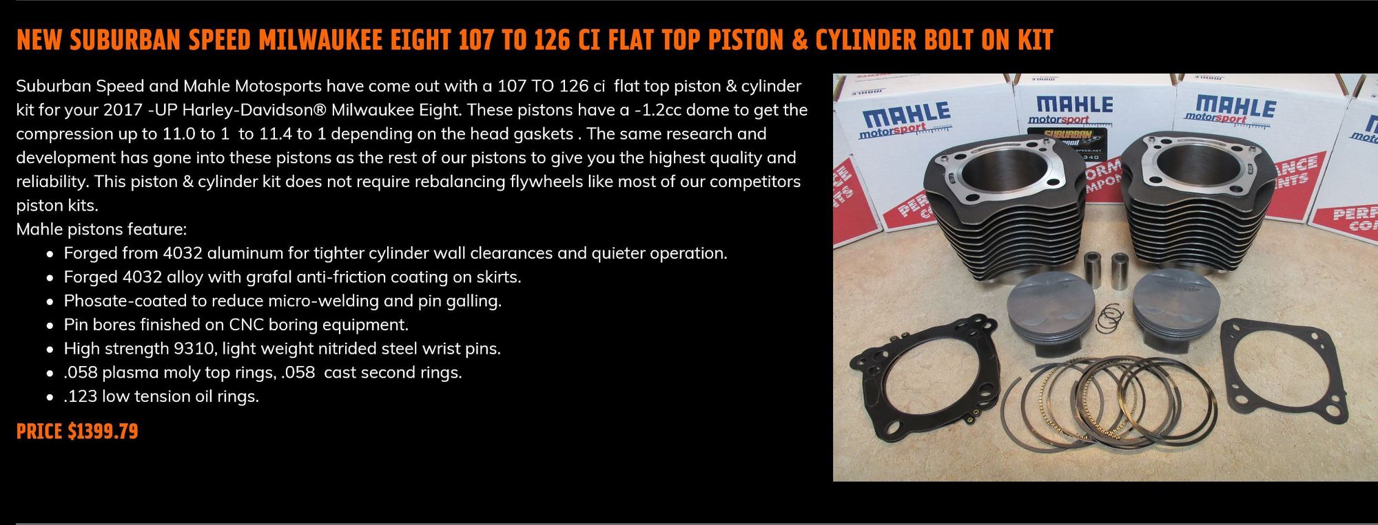

Originally Posted by AbitNutz
Wow! Thank you! Those look like exactly like what I'm looking for. A set of those at 11.0 to 1.0 mated to a pair of S&S cylinders may be just the ticket.
Thought this was a interesting set:
