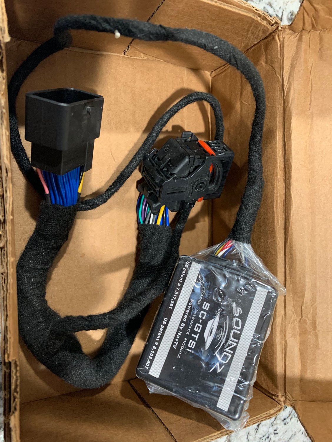

I put the GTS in my 16 RGU in October of 2019 (using a Soundz module), back then it was funny trying to get it "authorized"/programmed, specially when I asked them to take a ECM out of a 2019 bike off their showroom floor just for the initial programming but I convinced them to do it and in about 30 minutes all was good.

they are still clueless on this? crazy, I have an old soundz module, all you gotta do is plug that in, do the update and reset then remove the module and it works just fine.

As far as the ECM "trick"... I know that will work in older bikes (2014 and up) on the original radios (without a revision letter) if you have the Soundz module installed, I don't know for sure if it will work by just putting the '19's ECM in the bike just to do a software update... seems like it would though. What I have heard of people doing was sitting the "used" GTS in a 2019 and doing the update & reset mentioned above, then moving the radio to the older bike. Sounds like a good excuse for a road trip to Arizona from Kansas, or vice-versa. I do have a Soundz module laying around here somewhere.

Good to know, make sense too, because that Soundz module was for BEFORE the software came out and it just "fooled" the bike AFTER you temporarily put the 2019 ECM in the bike into the stereo think it was still in a 2019 bike even after you switched the ECMs back. Now once you do the software update, problem solved.
