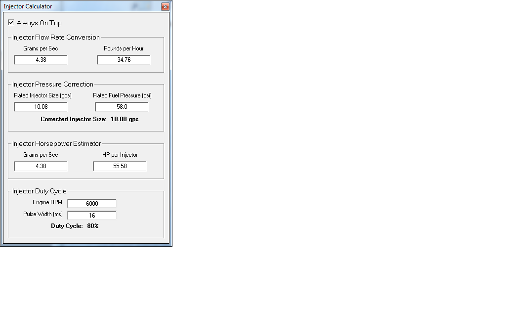

Originally Posted by Mopower
Were the 7.1 injectors you refer to DTT? They come with paperwork that shows they are supposedly tested and matched.
I am not willing to get into who's injectors we tested but I will say that we bought about 20 various sets and many came with papers with them about being matched sets. To say we are less than impress with them all is as good as I can say. The closest to being constant have been the HD ones. There is some very basic math that can be used to calculate what power levels can be made out of various flow rate injectors. The math is not a 100% but it will get you close enough and if anything it will always show you the minimum size correctly. The calculator show below is from our Mastertune product so any of you that have it can enter the values and see what you can get.
The above chart shows what you can expect to get when using stock M8 injectors. Like I stated before you may not get these exact limits but it will be very damn close. So your looking at about 112 HP max from the stock injectors on a M8.

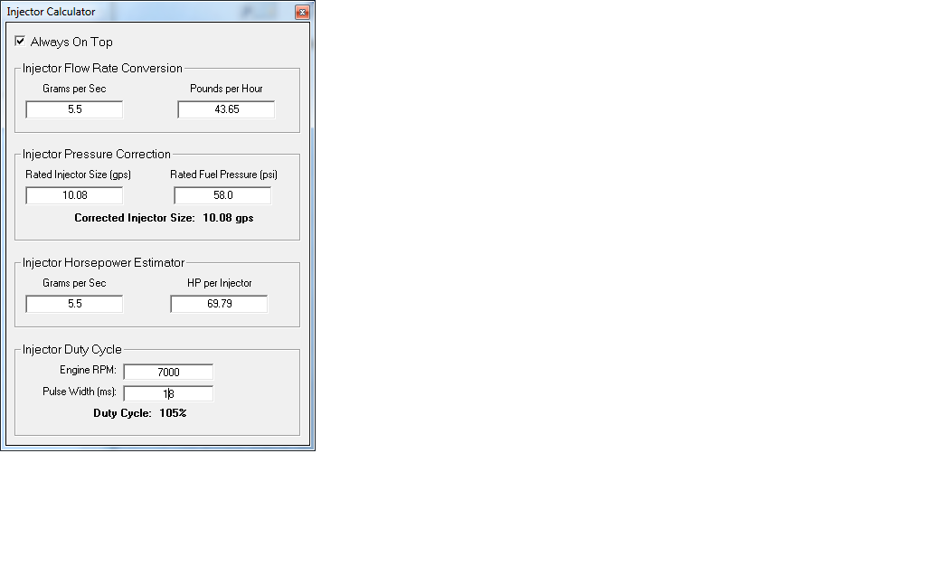

This chart shows the SE 5.5 injectors and there limit is about 140 HP. So the math works, as this is just where we see the 5.5 injectors hitting there limits in testing. The problem start to come in based that many injectors do not get the fuel properly atomized and into the ports properly. the spray pattern, position and delivery quantity is very important because as the engine RPM increases you have less and less time to get the job done. If you look at the above charts you will see the Duty Cycle is 90 % with a pulse width of 18 Ms @ 6000 RPM. Most injector manufactures (not resellers) recommend to not run the injectors above 85% Duty Cycle. So lets see what happen if we turn the RPM up to 7000 RPM..........................
So now the injector would be trying to operate at 105 %Duty Cycle and that's never going to happen. Hope this help some of you to have a better understanding of what's really going on.
