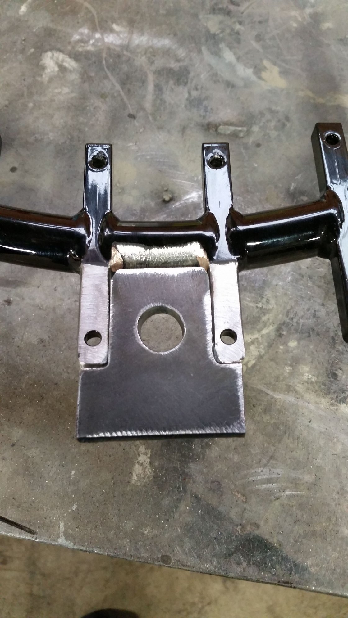

sixguns- what is the luggage rack and how did you mount the receiver tube? We’re there any additional parts to complete the install. Looking for details of your setup.

staffg, The detachable rack is from Harley-Davidson. This mount is on its 4th bike and sixth year of heavy usage without issues. The receiver tube is from Rivco, it bolts to the Tab welded to the rack. I advise not to go aftermarket on the rack, they are thin wall and may not hold up to freeway speeds. I run the pole at 7' off the ground, this allows for no worries with getting on ferries or other low clearance issues and keeps the flag off the Ground.
I cut the plate out on our burn table and welded it in. here are a couple pics, hope this helps..... Good Times
