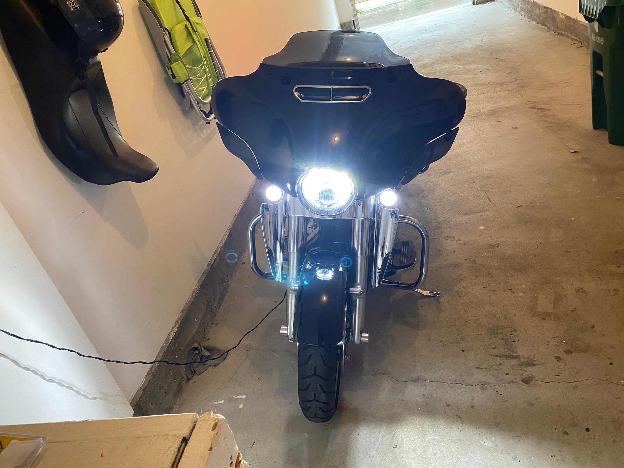

Headlight:
I really like the look of the stock headlight and installed LED bulbs instead of a daymaker.
Cost was $20 for both low and high beam bulbs. Very bright and light pattern stays same as stock.

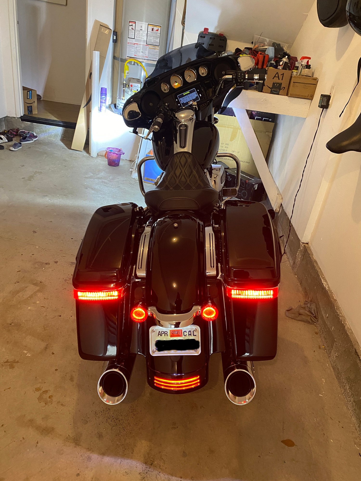

Turn signals:
Well, Custom Dynamics is an obvious choice and superb quality.
Also, install saddle bag signals with sequential light AKA Cylon turn signals

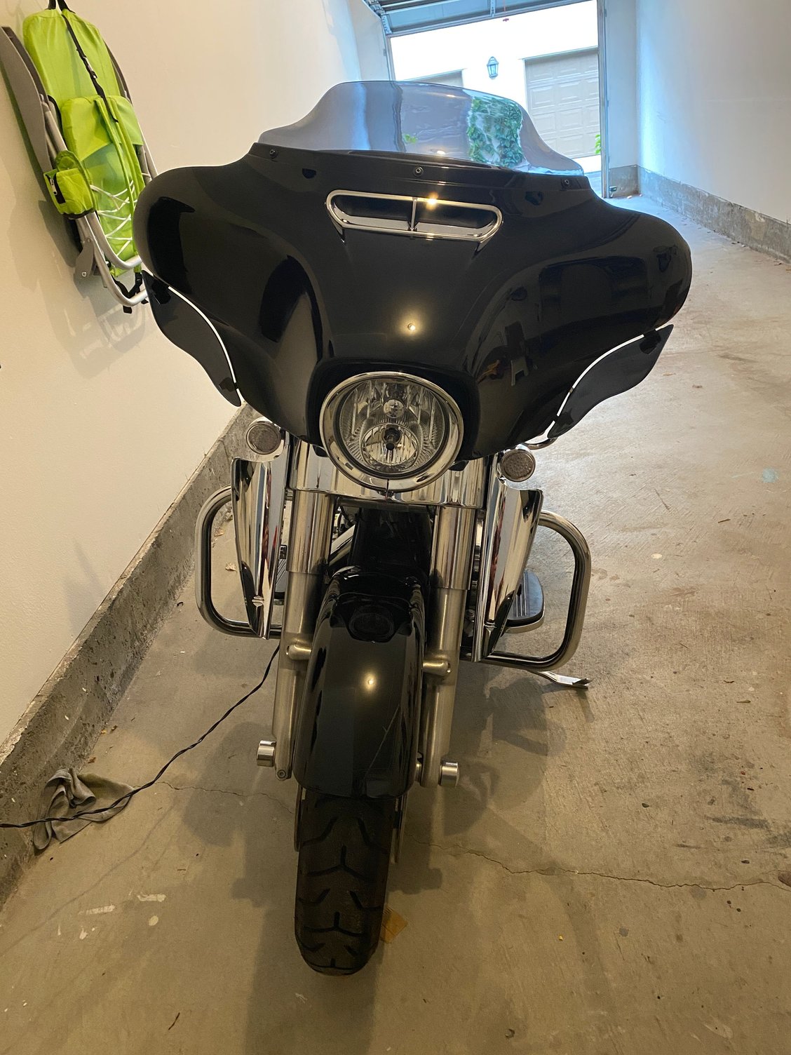

Buffeting management:
For reference I am 5’10” 180 lean and I have a half helmet.
I don’t mind a lot of air flow. I just don’t like it when my glasses and helmet shake/vibrate like crazy.
HD fangs really make a difference, they clean up the air turbulence. But not everyone like the look of them…. I do like the chrome fangs with black bike.
I also have hard lowers which I only used last winter in New England. Out here in Southern California they are not needed.
