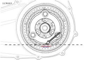

I am trying to lessen the first gear clunk as much as possible. Per manual .. the fill for my M8 is at arrow. The red line is my current fill... are you suggesting to fill at blue line? Anyone? Thanks!
yours is fine, close enough and not an exact science
