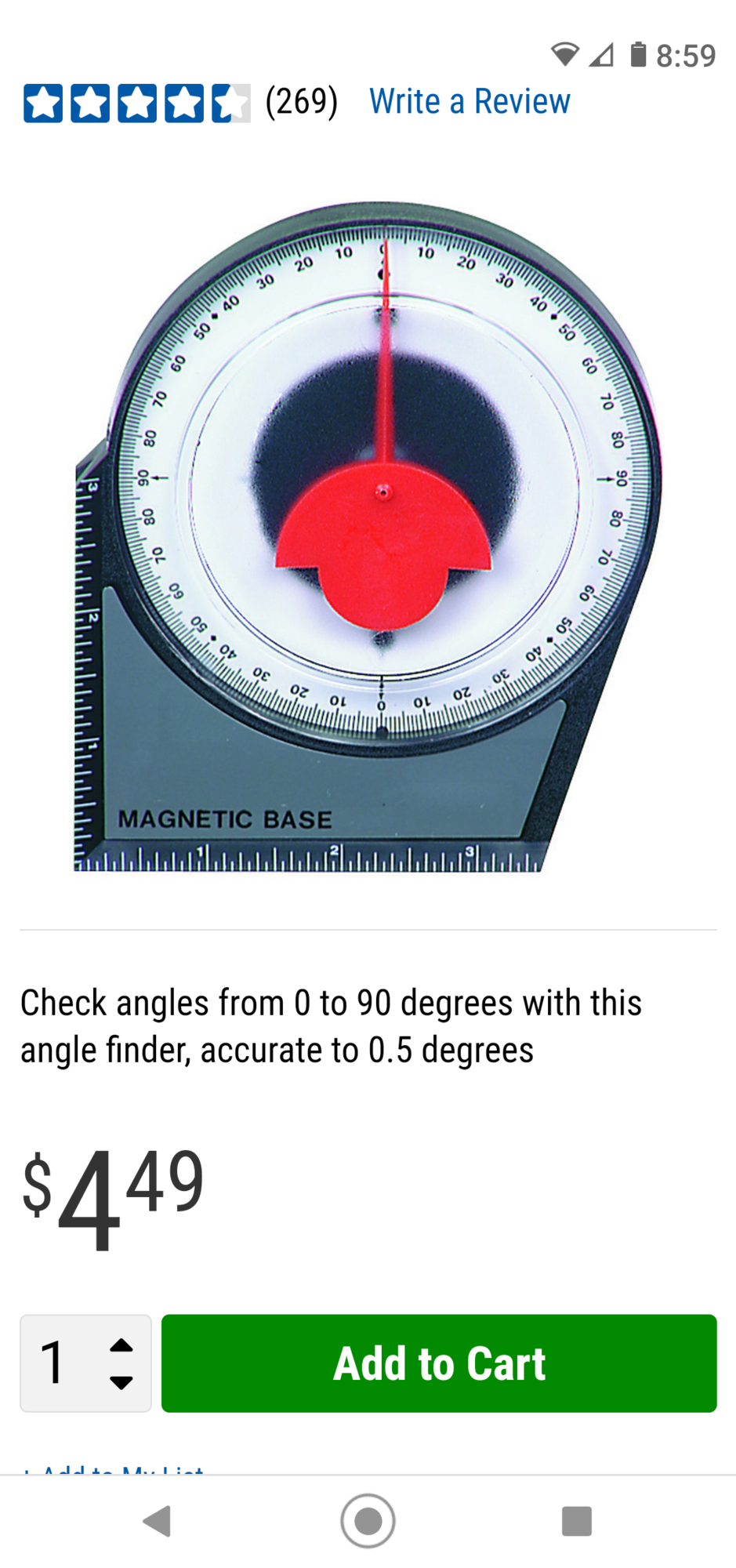

This set up is way too expensive and complicated.
It can be done with a $5.00 angle finder from Harbor Freight or even a short bubble level.
What I do is strap down the front of the bike. Adjust the straps until bike is strait up and down. Use the angle finder or bubble level on the front brake rotor to check.
Now check the rear brake rotor, if it's not strait up and down then you need to adjust the top brace. Older bikes are adjustable, new bikes are not and need to be replaced.
This method works on Dynas also.
