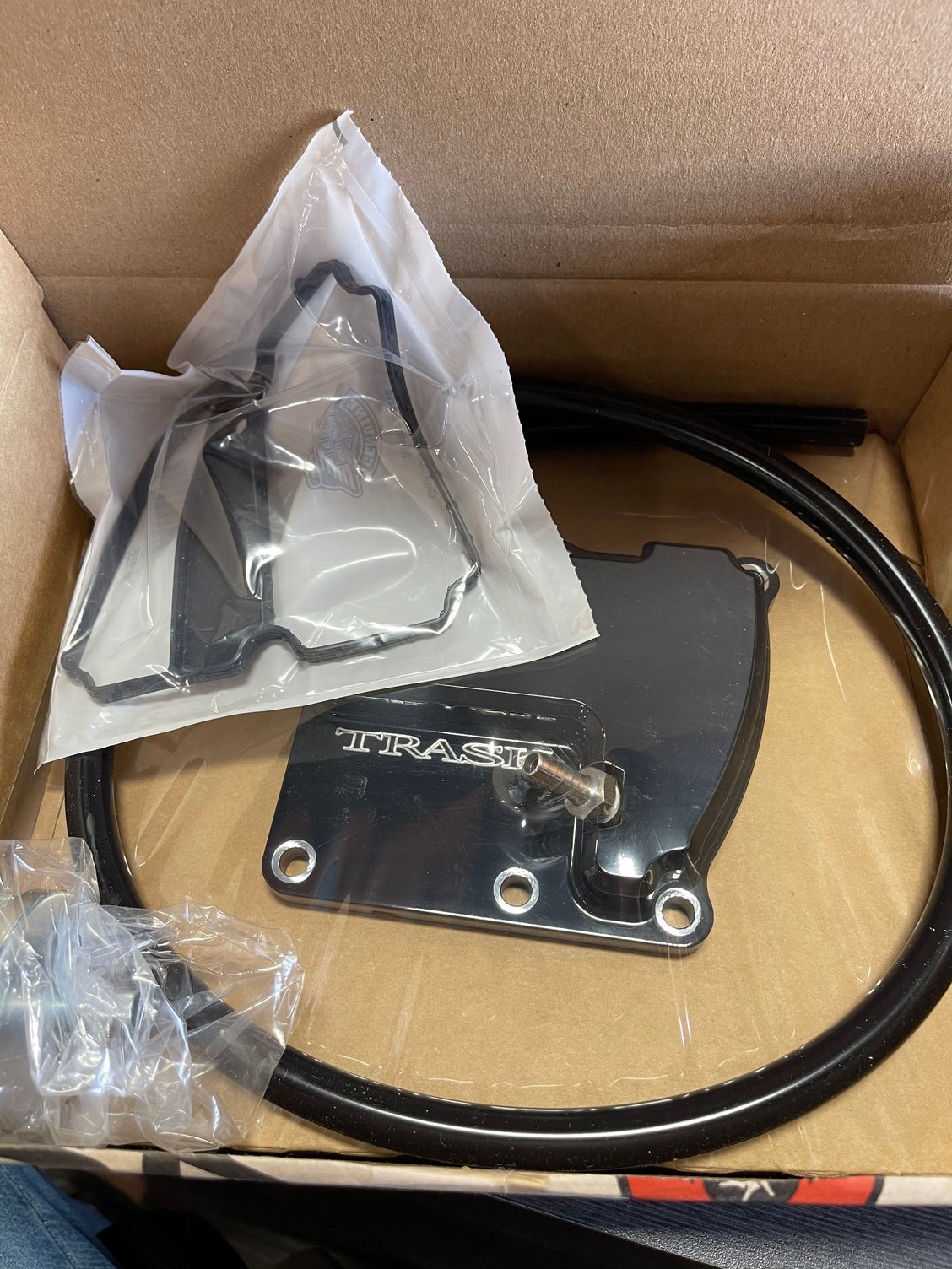

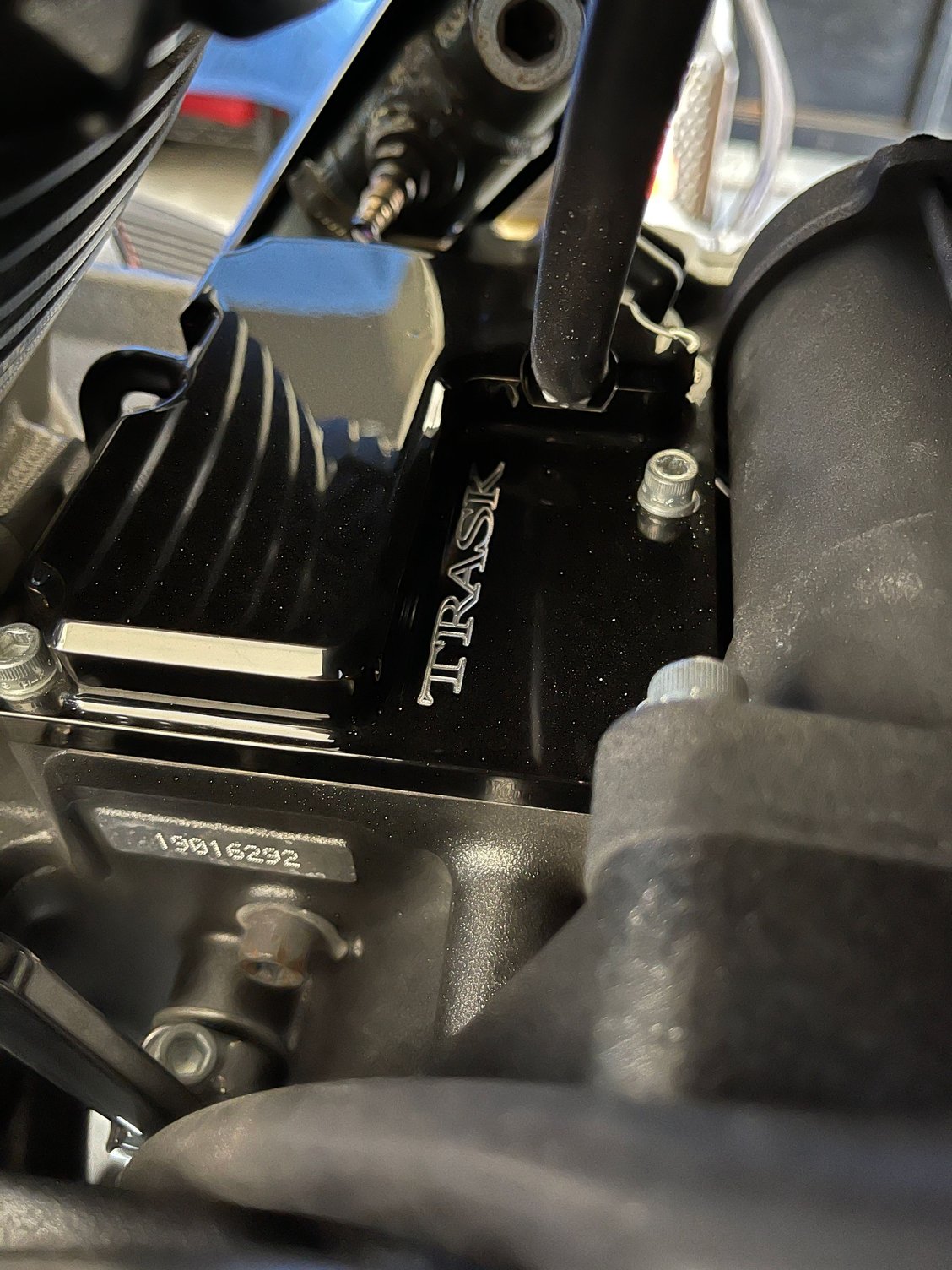

Trask just came out with a oil tank vent, I believe Quick has been trying it out, so there may be some credence into the need for better venting. How much extra venting is anyone’s guess, but, in order to get the moisture out there has to be enough flow to get it through the breather bolts. I know that at idle, you can feel the air coming out of the pill bottle, not a lot but it is pumping out air.

yeah I’ve talked to numerous builders and they say there is definitely benefits to venting this engine, especially if you’ve added ci’s over stock. Ive always liked the guys at Trask so when they came out with their vent cover I decided to give it a go, it is a very nice billet cover. Others have said they could drill and tap the stock cover and change the closed off stock gasket and put a one way valve, I guess they is true but for me, I don’t mind paying for a product that guys spent a lot of time, effort and knowledge into manufacturing and testing so that’s why i bought it from them.
