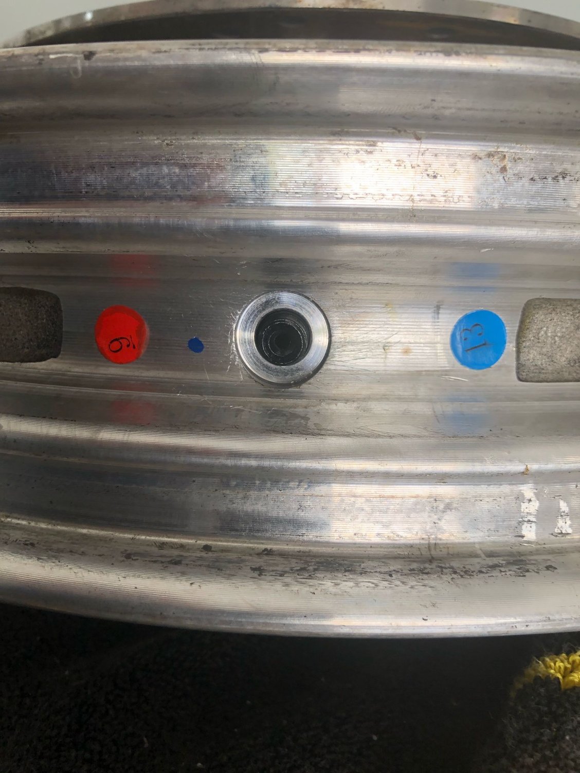

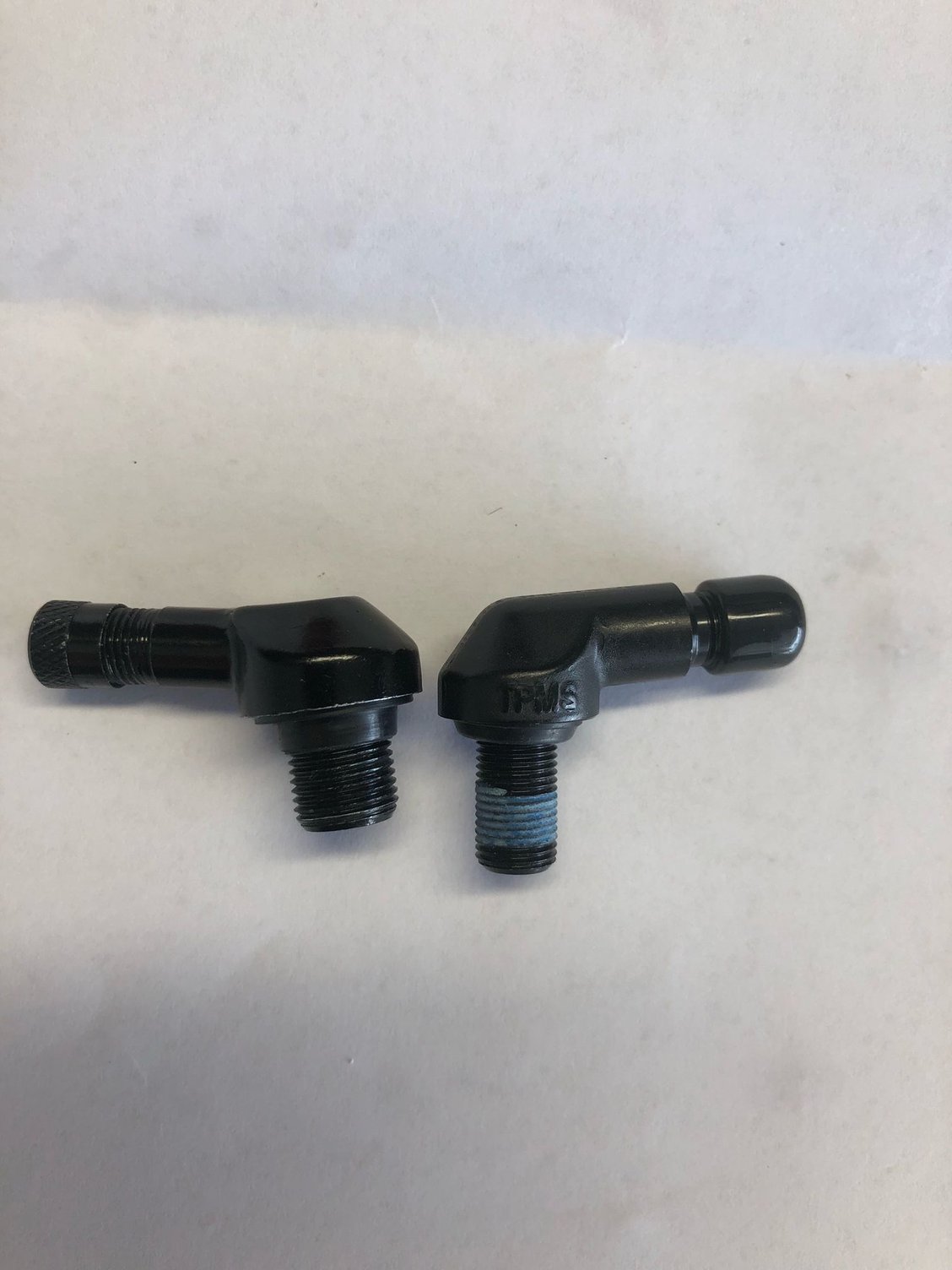

The Valve on the left is a cheap-o from amazon (11.3 mm) and the one on the right is the TPMS valve. If you look at the the base that goes into the rim, they're basically the same size.
This is the 11.3 mm, it takes up most of the space in the rim.

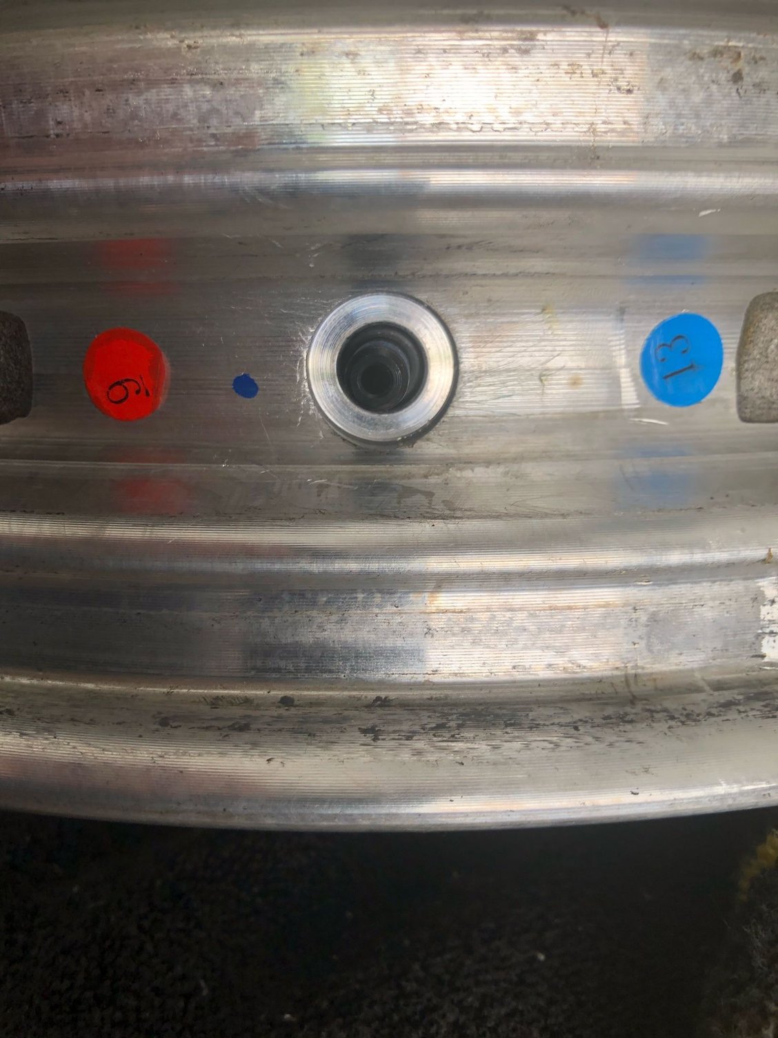

This is the TPMS (8.3 MM) in the rim. The gasket sits flush in the hole. I installed the sensor, put the tire on, aired it up, and no leaks. The TPMS sensor screws on clamps it tight and seals it. If you want, you can opt to use the the FOBO gaskets (I did because I ordered them) and it will go over the valve stem and take up that space. It does make it a PITA getting the sensor screwed on though.
