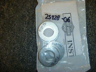

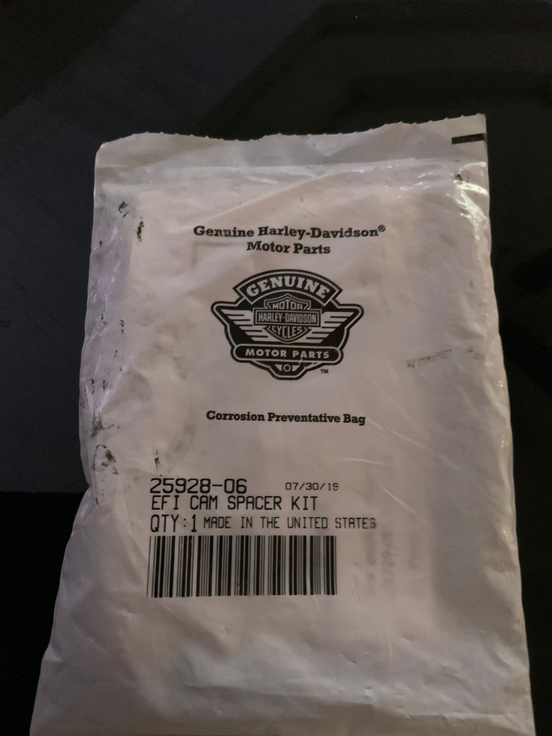

To my knowledge 25566-06 is the retention bolt kit not spacers. Cam spacer kit I use is 25928-06. Both of these kits are needed for a cam change.

Well look what I found in the bottom of one of my parts drawers lol. Saves me $6…
Just to confirm, this is used to ensure both sprockets are level, and are installed (if needed) in place of the existing spacer just under the cam sprocket, correct?
Yes, clean the bolts you take out for set-up and save the new ones for final assembly and proper torque.
