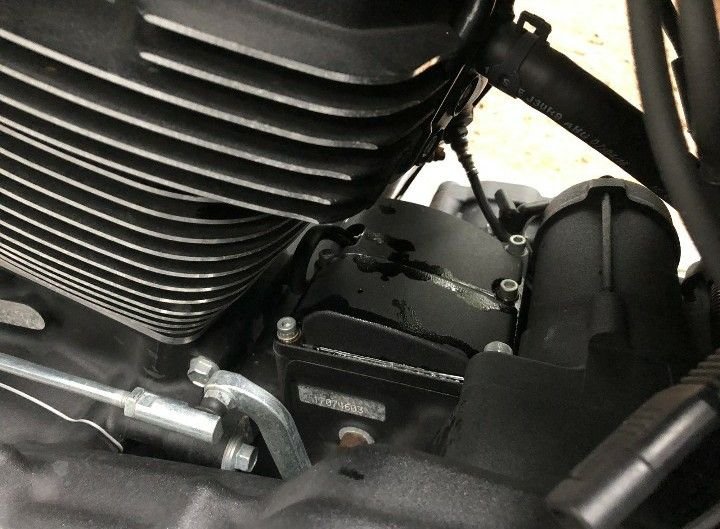

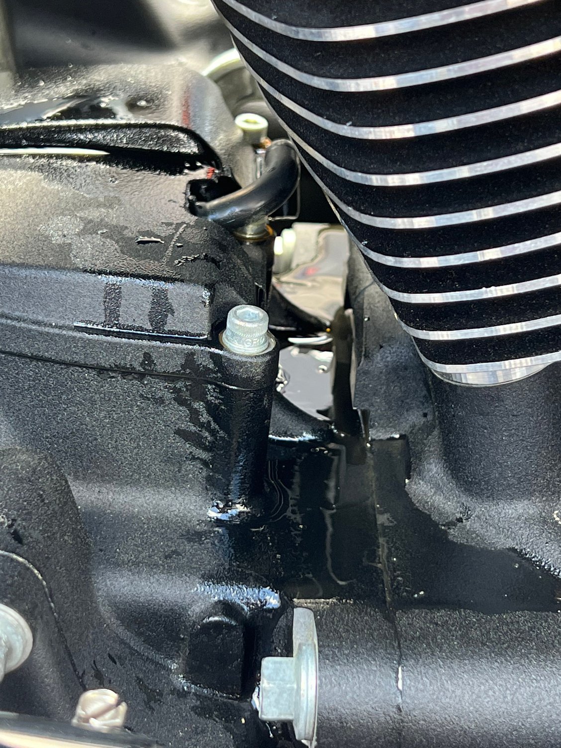

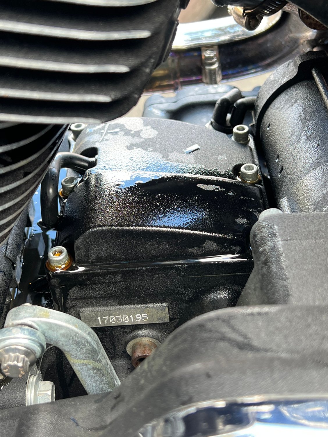

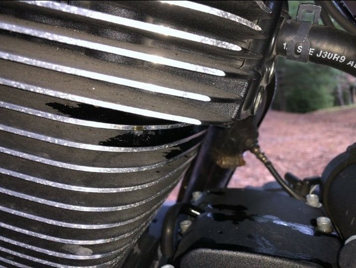

Rode to Myrtle and Savannah for the weekend. All in all about 700 total miles. Yesterday I noticed some liquid buildup behind the rear cylinder head. I got back to the hotel whiled it up and we left for home today. Parked in the driveway and took a look…I’m not happy about this as it was fine up until I took the this trip. Any thoughts on what it could be? It’s got a reddish tint to it so I’m guessing transmission fluid but it’s faint.

What fluid are you running in the tranny? Is it red? I run Bel Ray in my tranny and primary and both are red. If you are running red fluid it would seem that it’s coming from the tranny cover. Have you taken that cover off for anything? I would also shine a flashlight all through the fins in that rear cylinder.

Spray some degreaser on it, clean it up and watch it.

Transmision is over-filled. Coming out the breather tube.

Unless you are running Red Line or other "colored" trans oil. Normal trans oil in the usual golden color. Pull the trans dip stick to verify the color of the trans oil and level before assuming it's the trans.
Check you air filter for oil. Overfilled oil even to the full mark on the dip stick and running hard will often result in excess oil blowing out the vent tubes in the air cleaner.
