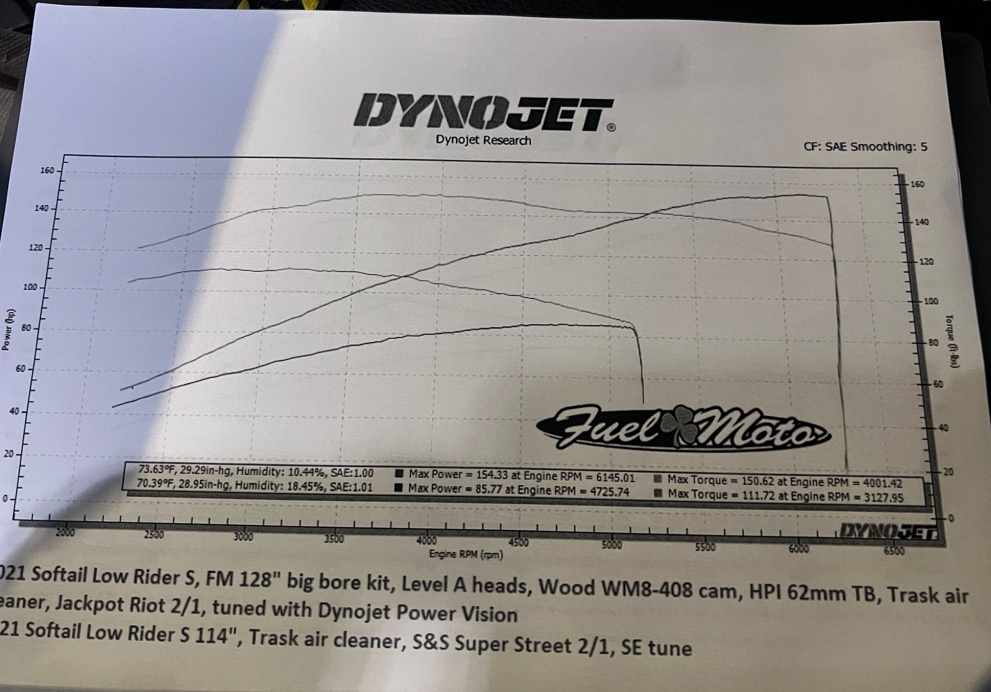

With 300 miles on the odometer I trailered my 2021 FXLRS about 1,000 miles each way to Fuel Moto.Went with a 11.1 128 with heads, SE throttle body with ward manifold, wood 408 cam, s&s pump and plate, aim clutch plate, com ramp, jackpot riot exhaust. Dyno tuned with power vision. at 154hp/150tq it is an absolute rocket ship, but it is also very streetable and easy to ride every day. I can't see myself not doing it all over again if I get another bike.

Very, very close to my build with similar numbers. I'll bet that bike hauls *** with that build....
