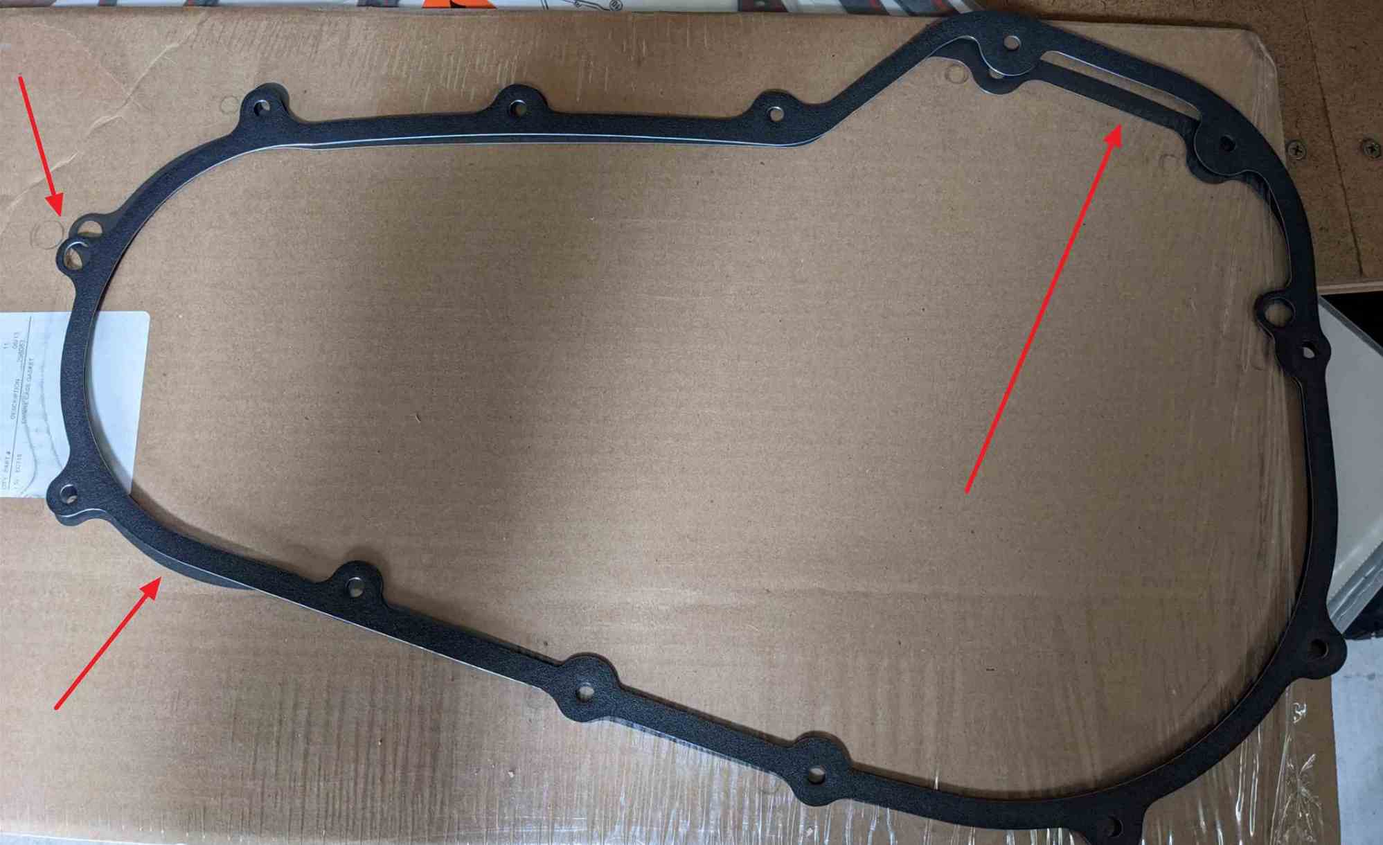

Here is pick of a 07-up touring primary gasket sitting on a 17 m8 primary. The front bolt hole is the big one since it goes into the case.. Notice that the M8 gasket has a little bump under the rotor. Bet you can pull the rotor without grinding the primary..
