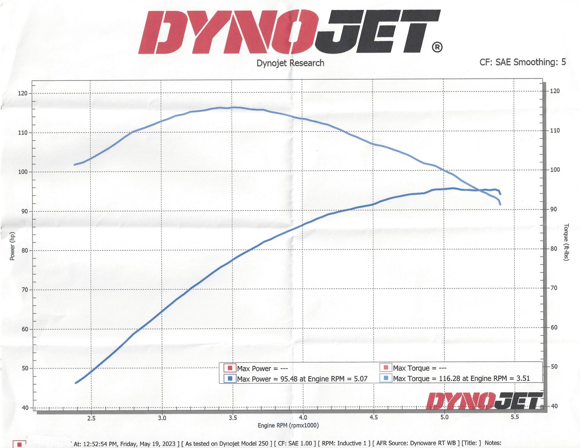

Originally Posted by Plow64
I'm having the Stage II TORQUE cam installed in May with stock head pipe, Rinehart DBX45 slipons and dyno tuned with SEPT. Will post the dyno sheet when it's done.
As promised:

Is RGS still the 107 M8? Did you go with the factory SE torque cam?
The Road Glide Special has the 114" M8. I went with the SE M8 torque cam (#92500074). https://www.harley-davidson.com/us/e...kit/p/92500074
Thanks.
That explains the slightly higher torque peak on yours, I have M8 107. My bike was last year with 107 stock for Heritage, they had 114 as an option but I didn't want to wait or order special, so bought off the floor. Still very happy.
