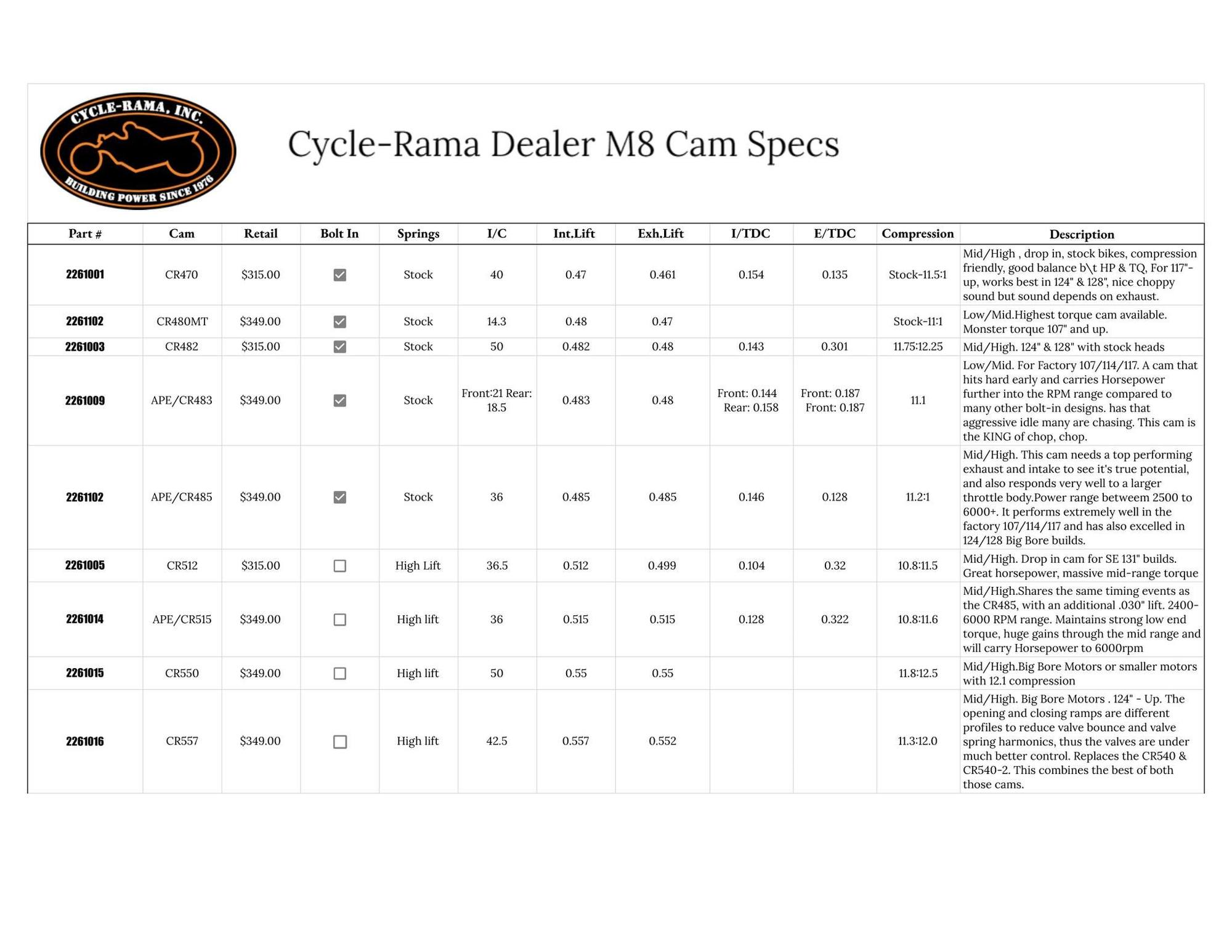

The 483 is designed for stock 114 I think. Before you tore it down would’ve been easy to try a bigger cam

i thought that also but the professionals say that cam should still work. i will be trying another one for sure.

CR 483 is a torque cam.

That cam will still work good in the 128. It’ll be a torque build. The power will hit hard and fast.
