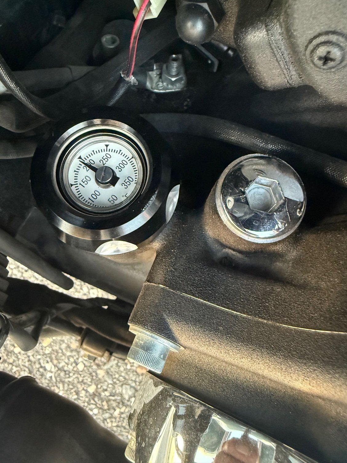

Today I got it out for the 25 mile ride to work with the temp dipstick.
temp outside was 72F, speed was 60 mph, 2-lane with some hills and curves.
It is supposed to get in low 90’s here this afternoon on the way back home. I will snap another pic then, see how much hotter it gets.
First morning reading.

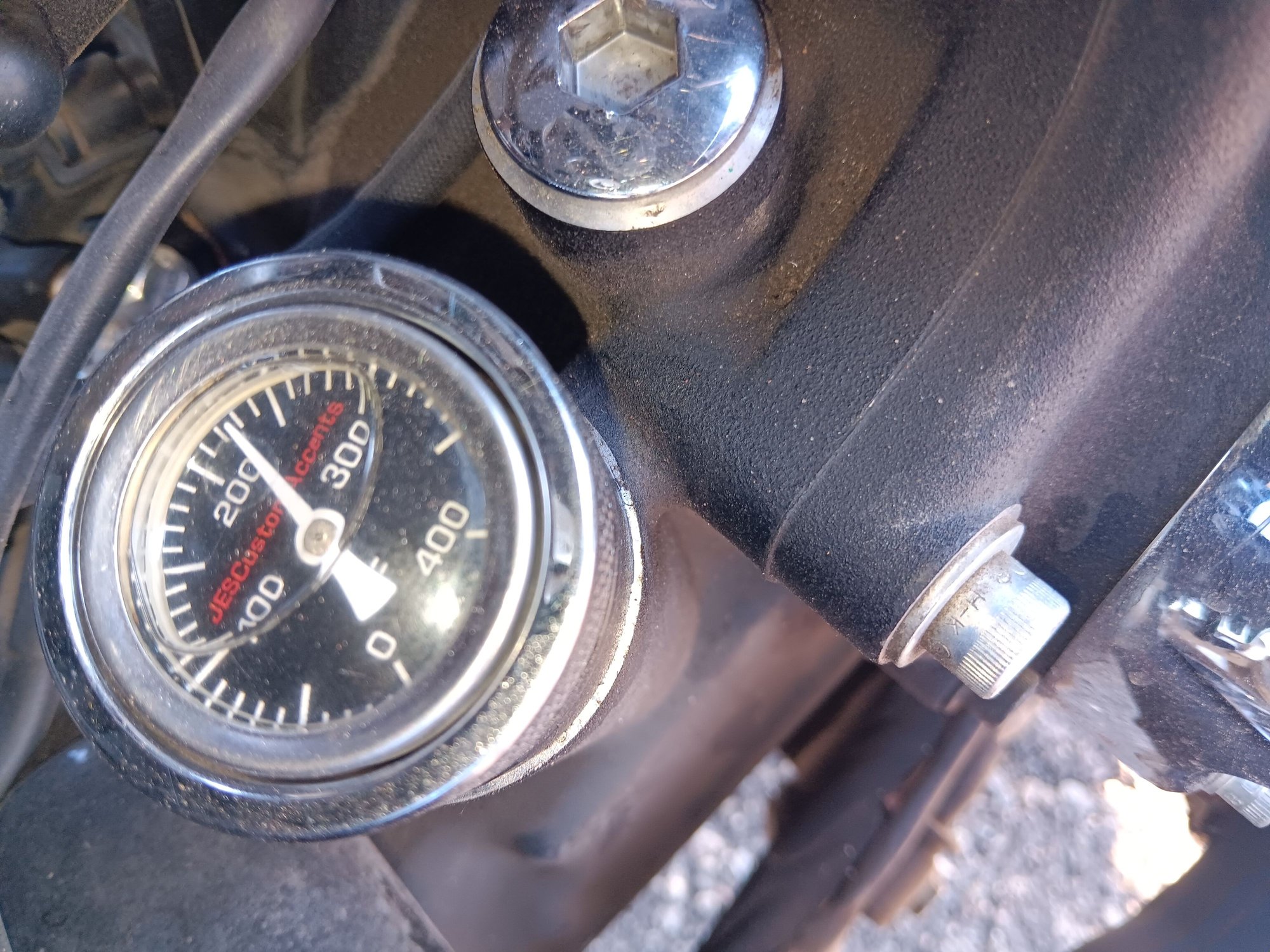

On the 6th I went for a 100 mile ride,combining two lane and freeway driving at 75 mph,when we stopped for gas the OAT was in the mid 90's.
The oil temp was registering at 225,

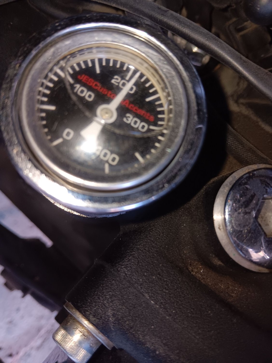

The last thirty miles was 55 to 60 mph and the oil cooled down at bit:
It is my believe that an oil cooler will only benefit the health of your engine, and aid in it's longevity. YMMV.

Those are good temps. After today it’s supposed to get a bit hotter, and then I’ll get on the interstate (70-75mph) and see where it goes from there.

People need to remember that too cool of oil is just as bad as too hot! The only way to get the moisture out of the engine oil is to cook it off and water boils at 212 F. So if you keep the oil to cool that never going to happen. With the temperatures your showing in your pictures there is no need for an additional cooler.
