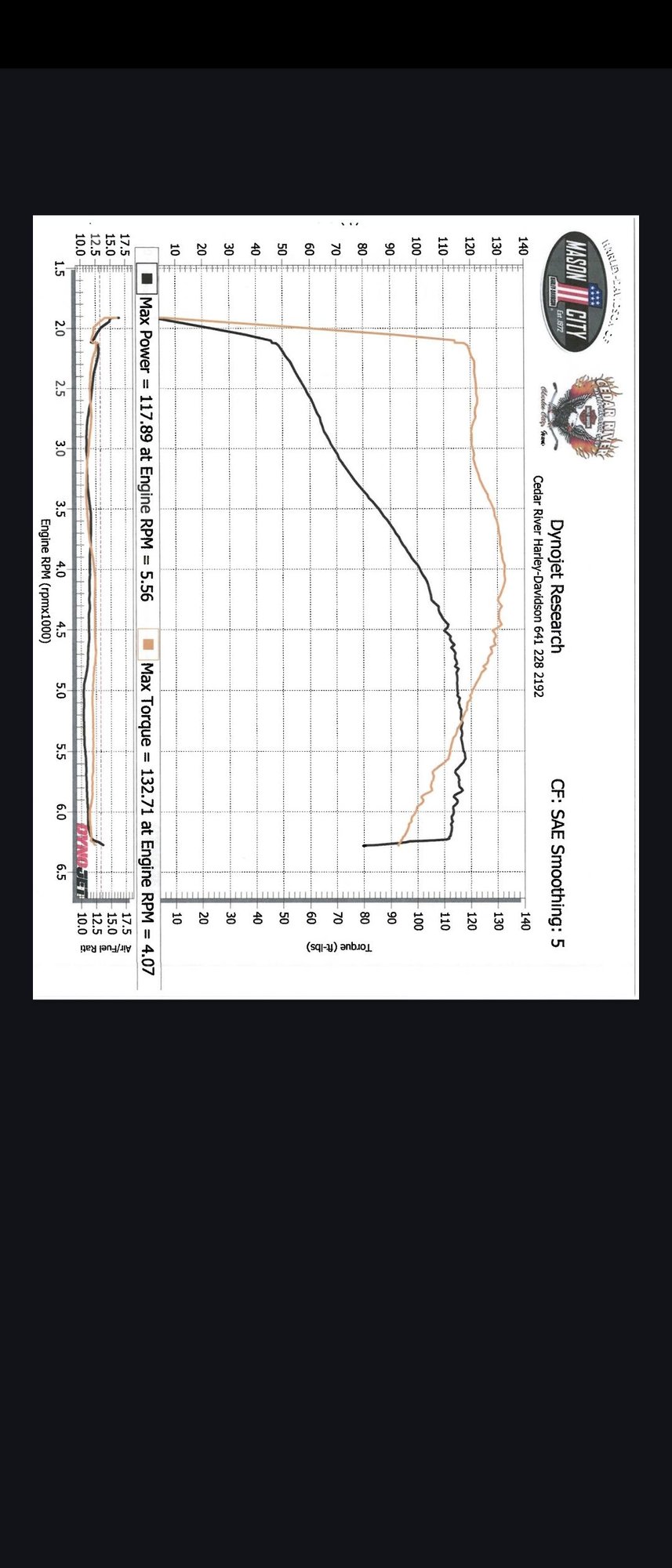

Got my 21 Street Glide 107 built by Harley, definitely not an all SE build 119. Used a Star Racing 30/30 cam and they tuned on a dyno. Exhaust was a 2 into 2 Khrome werks Hp+ with the spoon/performance baffle. I think it looks pretty good for what it is
​​​​​. Should be a huge bump from my SE Torque cam with the email tunes. I definitely don't know alot about the tuned bikes, curious about you guys thoughts.
Does this AfR look good?

looks good from my perspective

DerekG - just a little on the rich side, it's costing you some fuel mileage.

I'll definitely be ok with a little rich, probably better than the SE lean tunes.

Don't forget that is only a snap shot of wot. That part isn't that well done and that's the easy part. The rest of the tune who knows if it's fat or lean.

you might consider posting this in The Dyno Room forum on this site..I remember Steve Cole, our resident expert here, sharing results of his tuning of M8s very early on and mentioning that these aren't the same as their TC predecessors in open loop AFR, etc..he has a lot of experience with knowledgeable and valuable information he has provided to us all

Great feedback, thanks guys. I did talk to the tuner, he does tune all across the riding areas for AfR. He said of course everyone wants to see the peak numbers. It's a pretty gr Harley dealership right by where I live.
