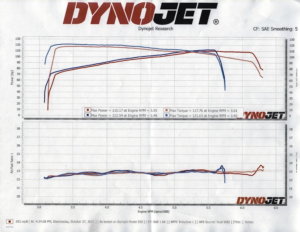

Here's how things stand now:

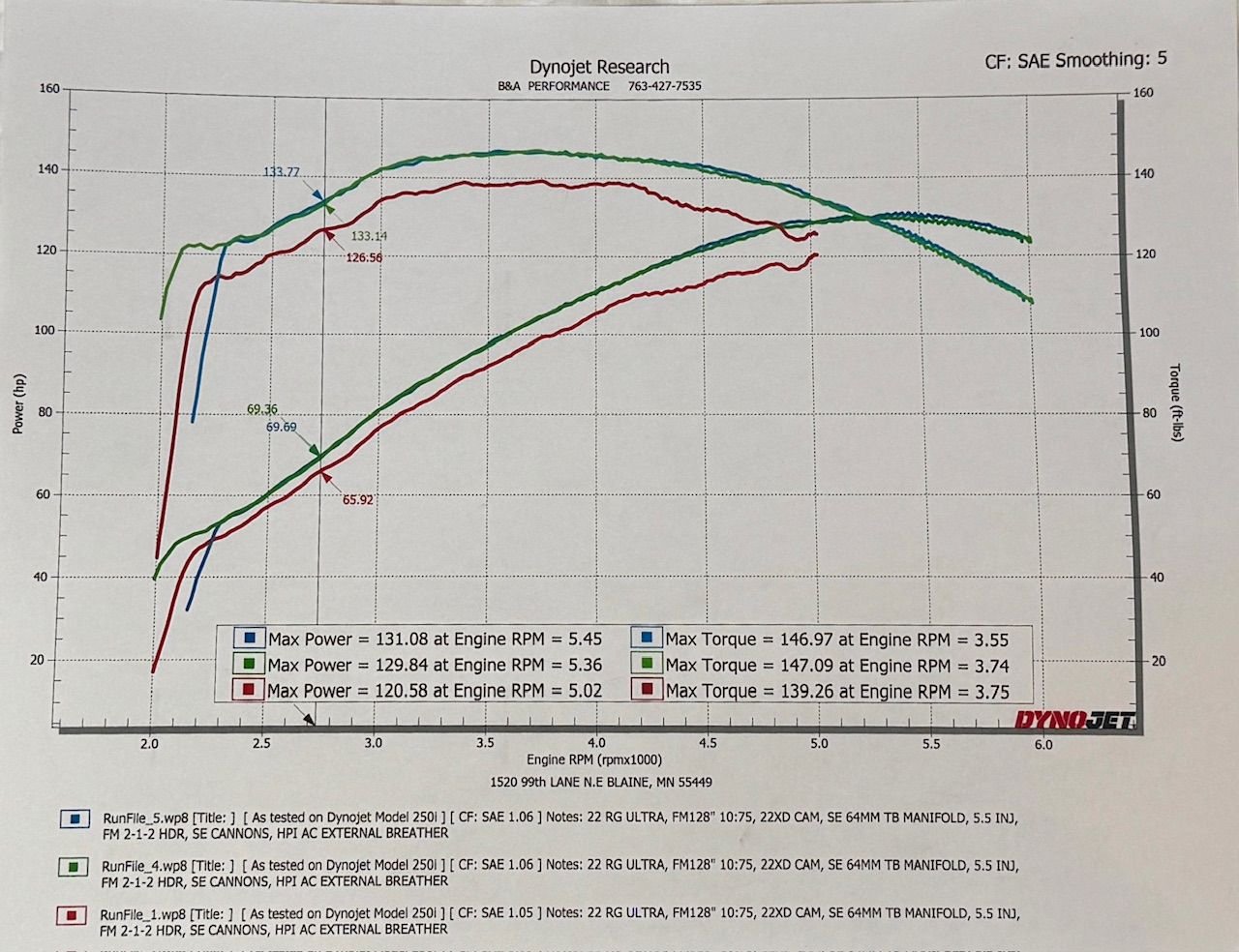

I used the FM 10.75:1 kit. 22XD, 64mm SE, 5.5gm injectors, FM headpipe, SE Street Cannons, PV3-B. You will like the difference!
