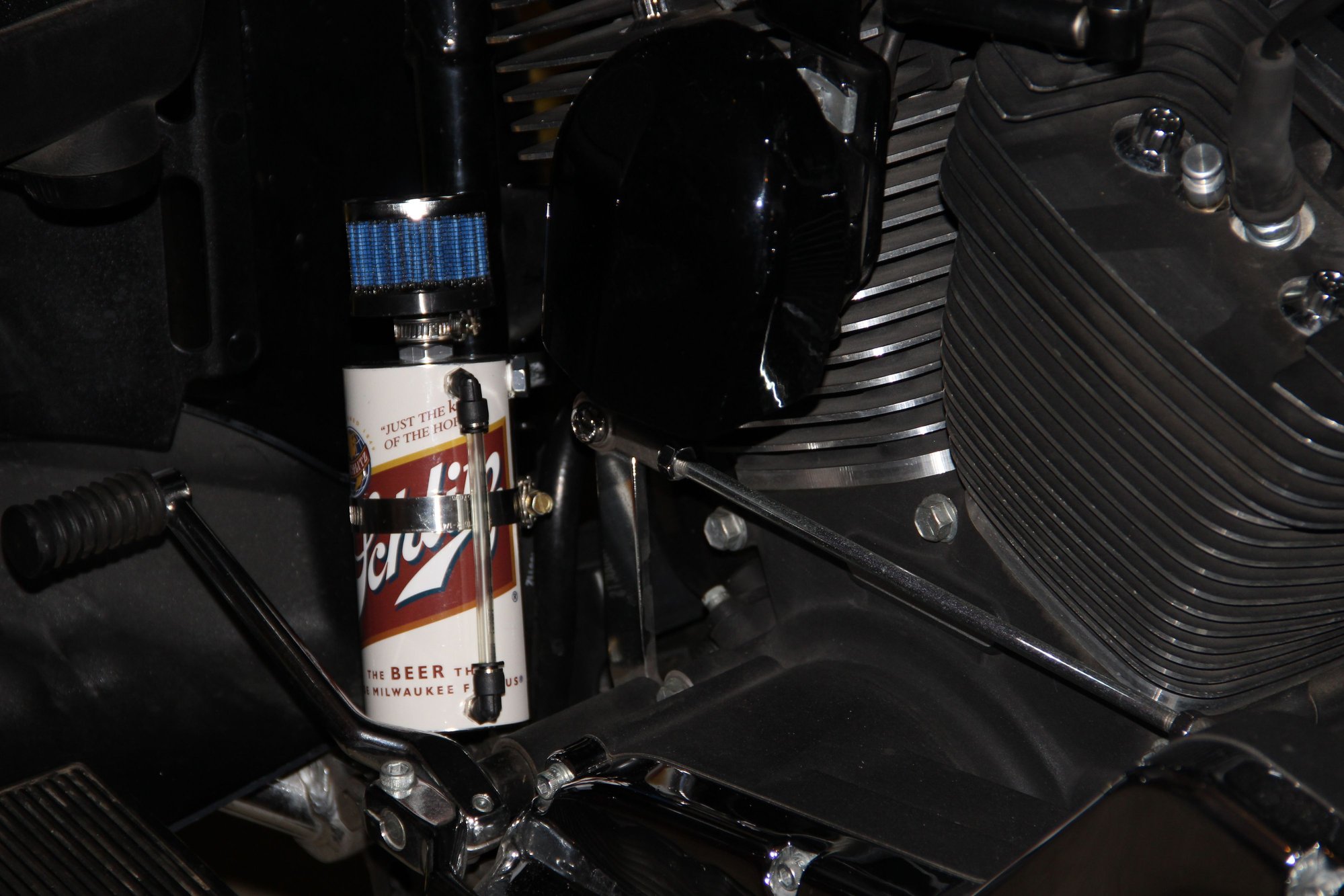

Answering you last line why go through the trouble of adding a "Catch Can" and the (ugly) extra hose when you could just make sure the oil level is where it belongs and don't over fill it as others here have suggested?
You're still gonna have oil mist, unless the engine is out of oil.
All engines produce oil mist. There's no way around it. Your daily driver produces oil mist, your lawn mower produces oil mist, the diesel powered truck that hauls groceries to your local supermarket produces oil mist.
The intake tract and combustion chambers of my ol' Harley are nice and clean because I vent the oil mist outside the AC. The right side of my bike is free of oil and the dirt it catches.
I had some fun that catch can, too.......
If the thought of having a vent hose and catch can hanging off your bike offends you, by all means, continue venting the heads as Harley designed.
If you don't mind cleaning the oil off the AC backing plate, the IAC plunger and bypass, and changing/cleaning your air filter at least once a year, by all means, continue to do so.
If cleaning dripping oil off the AC cover, the lifter blocks, cam chest cover and the right side of your bike is an enjoyable task, carry on.
The choice is yours.

What about a vented dipstick, such as the fueling one? Crankcase pressure would be reduced...

Mmm I don't think so. The path of least resistance will be the umbrella vents (it's easier for the pressure to escape the breather vent than it is to push the oil out of the way and escape out the vented dipstick.

I'm the first one for calling out HD on a poor job but the crank case vent system isn't their fault. The EPA mandates that excess pressure/oil mist be routed to the intake for "combustion". All anyone needs to do is route the breathers to two hoses, down to a T fitting and then one hose to the ground. There's no need for a filter as the umbrella valves are one way and there's no need for catch can. Actually, a catch can (depending on design and size) can impede pressure ventilation. As a side note, HD big twins have pistons the size of small paint cans which pretty much rise and fall at the same time. This creates a LOT of crankcase pressure.
Whether you decide to do this mod or not, the engine (and how the bike is ridden) will determine the oil level. Putting in more than that is at the very least wasteful and messy, at the very most pumping more oil into the intake/cylinders to be cooked onto the piston tops. Once that sh*t is caked on good it can super heat faster than the piston material itself and cause pre-ignition. Look that one up, its expen$ive.
In my opinion, kibbitzing about what cleaner/wax to use or what chrome gee gaw cover to buy next should all be secondary to venting the crank case to the ground.
