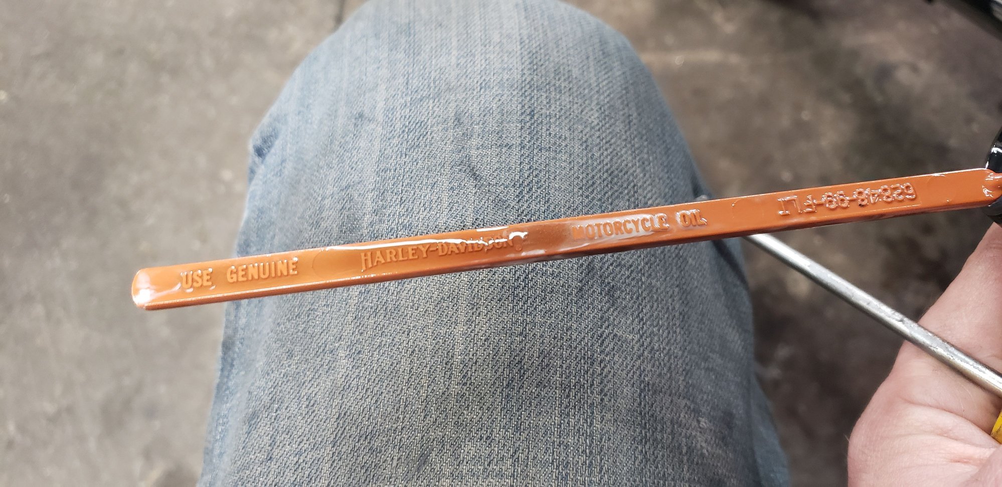

Can someone tell me what this white stuff is on my dipstick? 05 95" road king with regular drag 20w50 in it. Pulled the dipstick, saw this stuff. I figure there is information there I don't know about.

Usually a sign of moisture. You parked? Not starting it like some do ever week or so running it a few?
I wouldn't worry about it. It will dry out after a good hour run.

Yeah it'll be 20+ times worse if there was an issue.

Condensation. Results from short rides or starting the Bike in the Winter months and not getting up to Operating Temperature.
