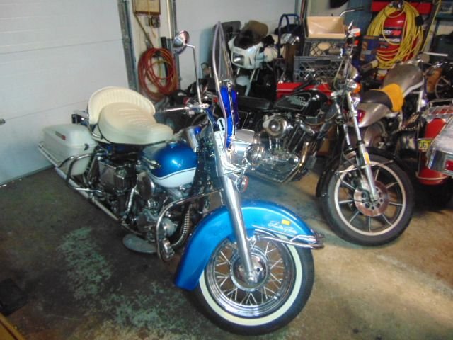

we did a few 65s and the finish is cad plating and no park on the first electric start machine - the bolt heads with some not all is CP and a very few CP 1038 and even CP 1041 bolt head inscription
this is one of them they were both the same color
