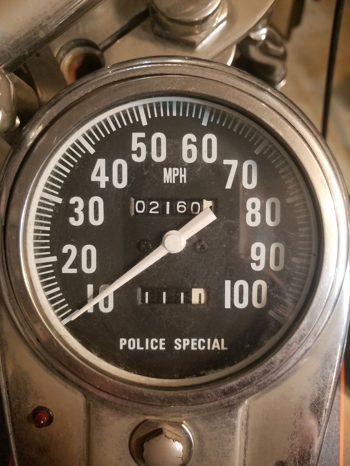

Does the speedometer look like this? Not kinda, sorta, yes except that are an ansewer. This is correct for 1948-1950 HD
These units are gear-driven. The cable goes from the unit itself (the head) to a drive that runs off the transmission. If it is not functioning it is either the cable, the gear that drives the unit or the speedometer itself.
An original speedo is going to cost you about $300 for a rebuild. John Bordas is the"man" to do it. The c h i n k **** that are copies are about $29 and will last about 29 days before taking a dump. No one rebuilds the Tawain Ted crap.
Can you post a pic of the speedo face. It will be an easy tell if it is real or Memorex.
What johnjzjz is providing is a way to determine if the speed is functioning properly

My dad must have changed it out, see attached.

Yes been changed out. now the question is it is a Stewart Warner. If so it is worth the rebuild, and as I mentioned, John Bordas is the go-to for that. Not cheap but the best, I beleive, in the USA. The Stewart Warner sig should be at the base of your speedo unit in small white lettering.

Think he pulled it off a 2000 Road King that I sold. My though was he could see the numbers better because they are alot bigger.

its a re pop - the trans is a 5 speed that uses a front wheel speedo and you have a springer that does not have an aperture - look on the rear wheel to see if the cable operated drive is on that -- the bikes is way past custom to even consider bringing it back - enjoy it don't worry about the small stuff
