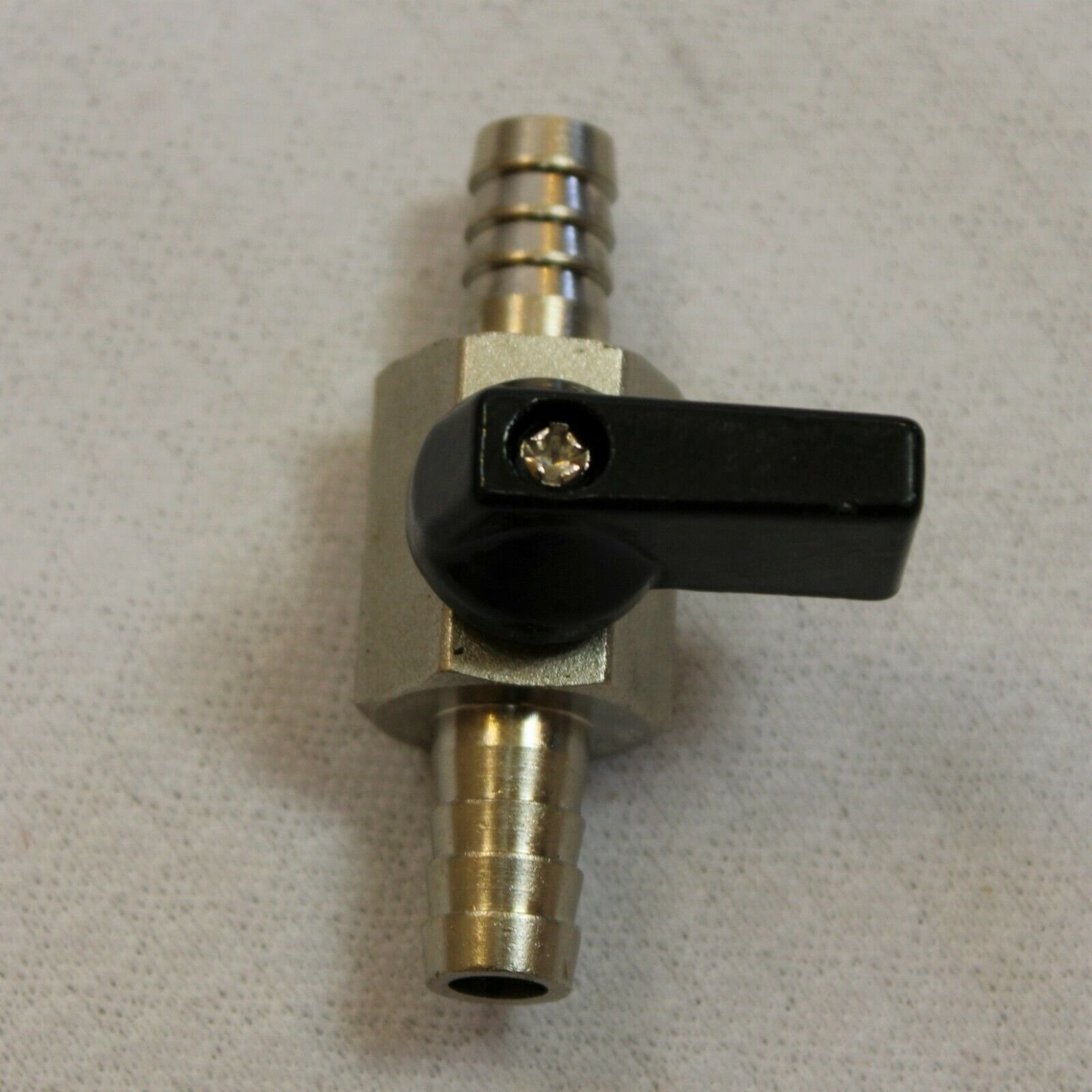

New data: the total oil expelled was 1.5 quarts (see pics 1 & 2), and this doesn't include what I mopped up from the floor. That's just far too much for me to tolerate because it means carrying 2 quarts with me anytime I go anywhere--and I plan on riding this bike a lot. Plus, there's leaving a pool (rather than a few drops) in someone's drive or parking lot, and the potential that I'd get it on my tire and go down. No good.
Permanent solution: I wracked my brain, thinking about catch cans, fiddling with the rotary valve, etc... and then it hit me. All I have to do is insert a full-flow ball valve (3rd pic) into the line from the bottom of the oil tank into the pump's feed nipple... and voila. This will never happen again. Problem solved, permanently, for a couple of dollars. Just amend my startup procedure slightly: 1) open fuel petcock; 2) open oil feed ball valve; 3) choke (or not); 4) turn on key and kick her.

Or you can fix the problem with the oil pump check valve and not risk forgetting to turn on the oil.

I've installed a new spring and ball. What problem do you anticipate occurring with the check valve?

Some people have forgotten to turn it on is all.

There's a tool you can use to fix the check ball seat, others have made the tool.

The seat should be cleaned and/or lapped so the new ball has a new surface to seal against. It is odd that this just happened after a long time of not being a problem. It may just be a piece of crud under the ball?
