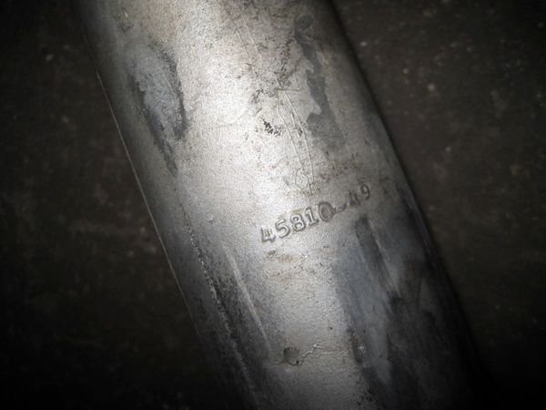

Nice long-term project. I'm thinking your bike is mid to late model since your VIN numbers start at "6". My references show a total of 8,014 FL units for 1949.
As John has said, Palmers 3rd edition is a must for a serious restoration. It is a 2-volume set that covers each model year from 1936-1965
Make notes, take pics as you take everytrhing apart. I probably have well over 300 hundred pics of my 49 redo and sometimes I think that I still didn't take enough.

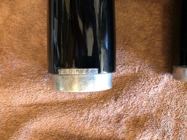

49 fork tubes should look like either of these two pics. From the factory the tubes were painted black'

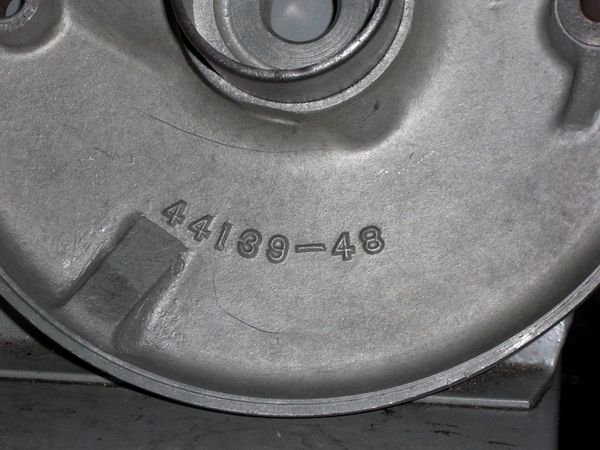

The 49 only front brake backing plate actually has a 48 part number on it.

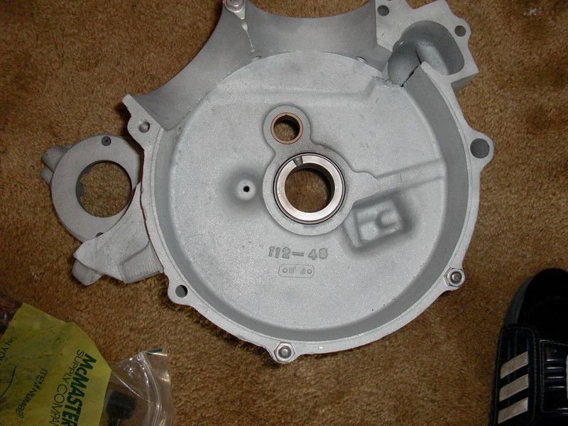

Another thing that may assist in identifying when your bike came into the world are the casting numbers inside the case halves . "F8" = June 1948. Case half for my 49 EL with a VIN# below the first 500

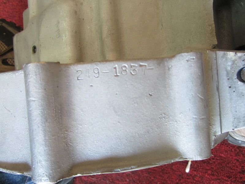

Lastly have you checked the belly numbers on the bike. I would guess that they are matching but it always helps to verify. Belly number for my 49 EL. Left and right match

The spare backing plate is cast with 44139-48. The unit on the bike, I suspect, is original or installed with the finned drum. It appears to be sand cast as well.
I am curious about the belly numbers myself. The skid plate covering the motor is caked with grime and hard to access with a tire flatter than Kansas.

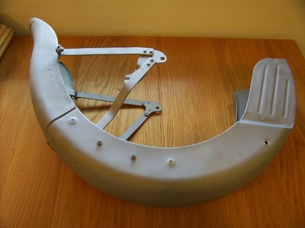

The rear fender is stamped with three “grooves” forward of the tire. Early fenders are smooth.
I am curious to know the number of spot welds securing the bracketry to the front fender. My understanding is very early fenders had three per bracket with later models having 13+\-

Original 49 rear fender
Would not do you any good to show you a pic of the pre-done front fender. The front bace to forks bracket was twisted all to Hell. Found a correct pair of braces and had my welder remove the old and in with the new. He cursed me for a couple of months after rehab on the front fender. Finished you basically cant tell
That looks amazing! That’s one of the many things that makes a build. Money and time well spent!
