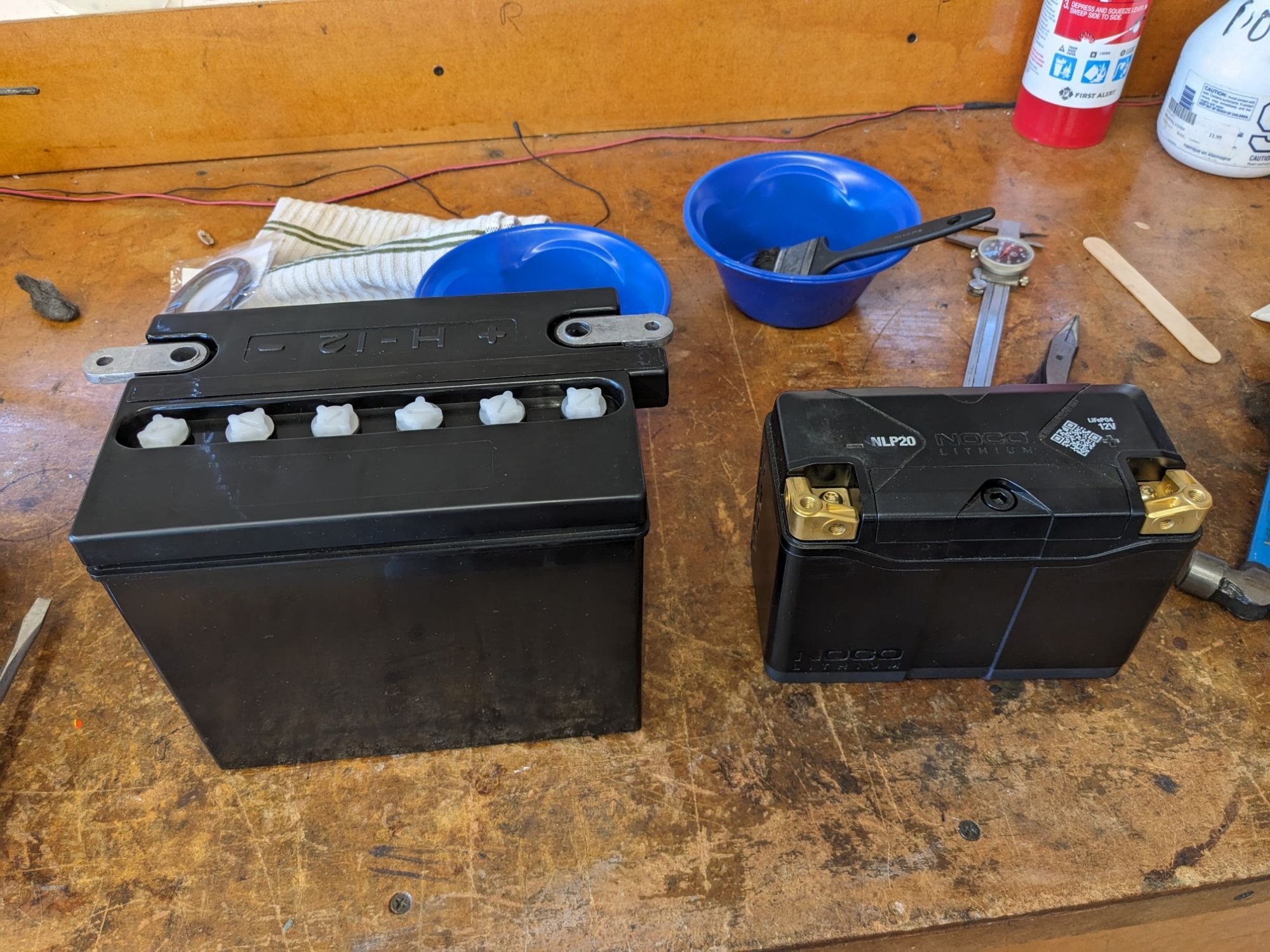

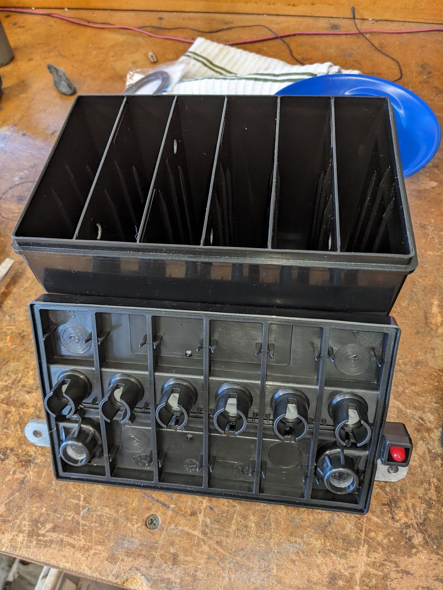

Bought a empty battery box that can be used to fit a more modern battery.. Interestingly it looks like a battery cases without any guts.. Have to cut out the cell separators. Anyone ever do this to fit a more modern battery?

Careful lithium battery go on fire if the charging system has to many volts and amps
generator machines 13.7 the most and 5 amps or the battery explodes - how i know this it happened twice

That was kinda what I was hoping.. Just kidding.. It's not the 5 amp but overvoltage (or under) that kill them.. Could go with a newer solid state regulator but will probably go with a standard battery. I was thinking about using a standard series AGM like in the later FXDs and softails but they really wont fit in the battery case..

Scorpion battery 370 amp AMG - all we use to replace the H12

Damn that is close to the stock HD acid battery. Keep hoping that someone will come out with a replica case that takes an upgraded high amp battery inside it. Have something like that for my 49 EL that I converted to a 12-volt system.

I gutted an old 6 volt battery that fits inside the horseshoe oil tank on my Panhead. Two modern AGM batteries fit inside. Looks stock from the outside and no battery acid.

I run the Scorpion battery that John recommends on my 1970 FLH, no acid, starts the bike just fine and same size as stock, cable locations are perfect. I got almost four years out of the last one, just replaced in kind a couple of months ago. I accept four years of life for $150 dollars, and it won't light the bike on fire.
I have a fake battery box on my 45 with a lithium inside. Been like that for about 4 years as well. Bike is converted to 12v with electronic voltage regulator, no issues with fires. Battery works well, more than enough for a kick only. Battery Box guy who has an ad in the AMCA magazine is where I got it. Pretty sure I bought it from him in person at Oley years back. Not sure if he is making something for the Electra Glides, I would track him down and ask Good luck.
