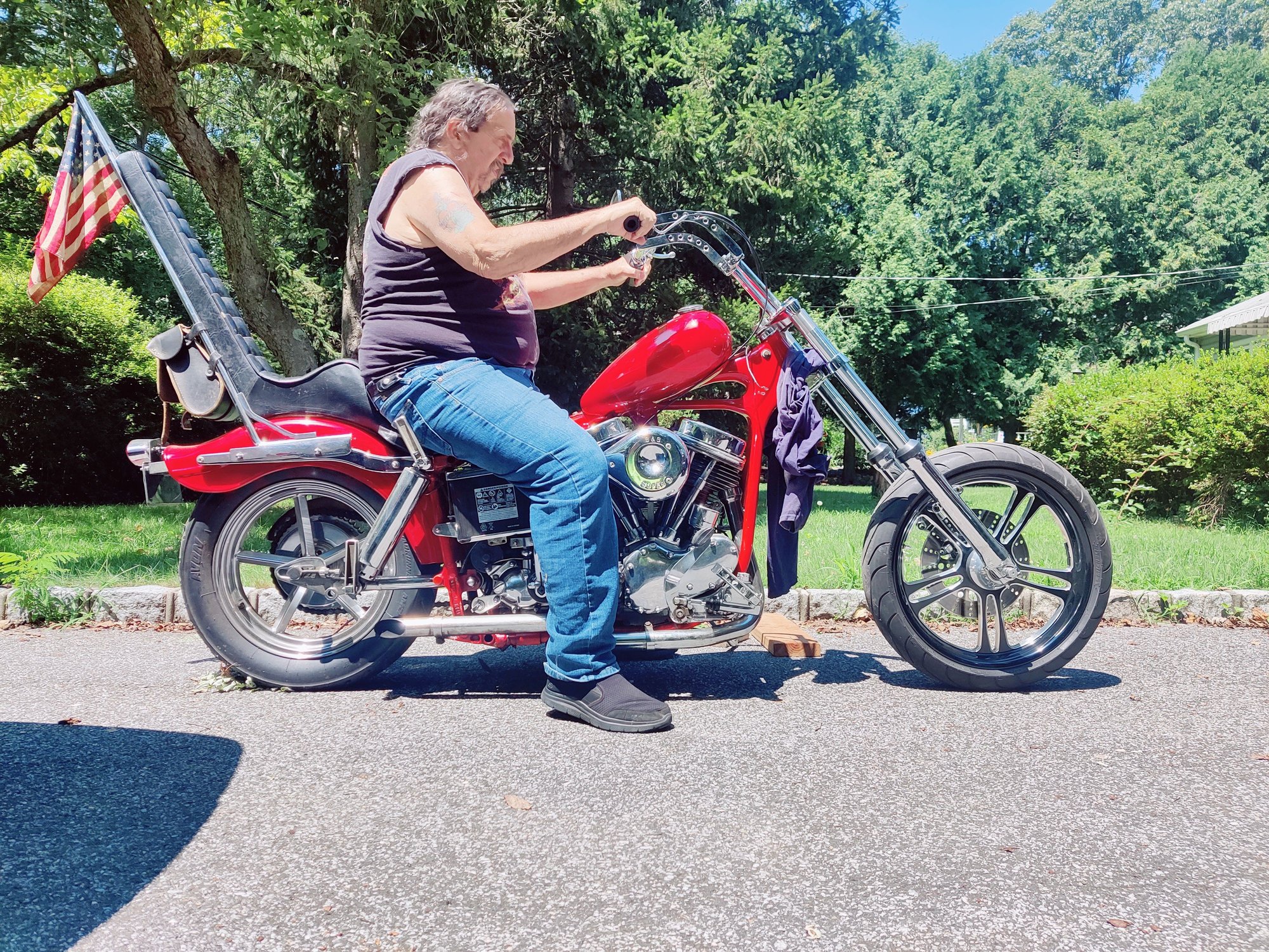

As stated.. I'm helping a friend replace the springer front end he had on his 58 Pan. He has had the neck raked years ago.. I used my Wide tubes and sliders with +2" extensions and my 19" front wheel to mock it up.. We determined this was the length he wanted but he's having a very difficult time locating Smooth Sliders (no caliper mounts).. He also has the front rim that matches the rear just no mount for a break rotor.. If anyone has a line on a set of Smooth sliders I would with 5/8" axle bores I would appreciate it.. Thanks..

Back when the chop crew took FLH legs and had them turned down or just cut the tabs off. Find a set of bare wide glide legs and spin them down & chrome them, gonna be easier than finding a set I'll bet.
Oh and if those are the old school welded spoke you can get 3/4" bore bearings to make things a bit more common.

Thanks that's probably what we will do and I had considered the 3/4" bore bearings for that wheel.. They're smaller than normal.. I have measured them but I forgot the size, I believe they're 1 3/4" diameter.. But yeah turning down and smoothing is probably going to be the way we go.. I was just hoping that I could find some just to make it that much easier thanks TwiZted..
