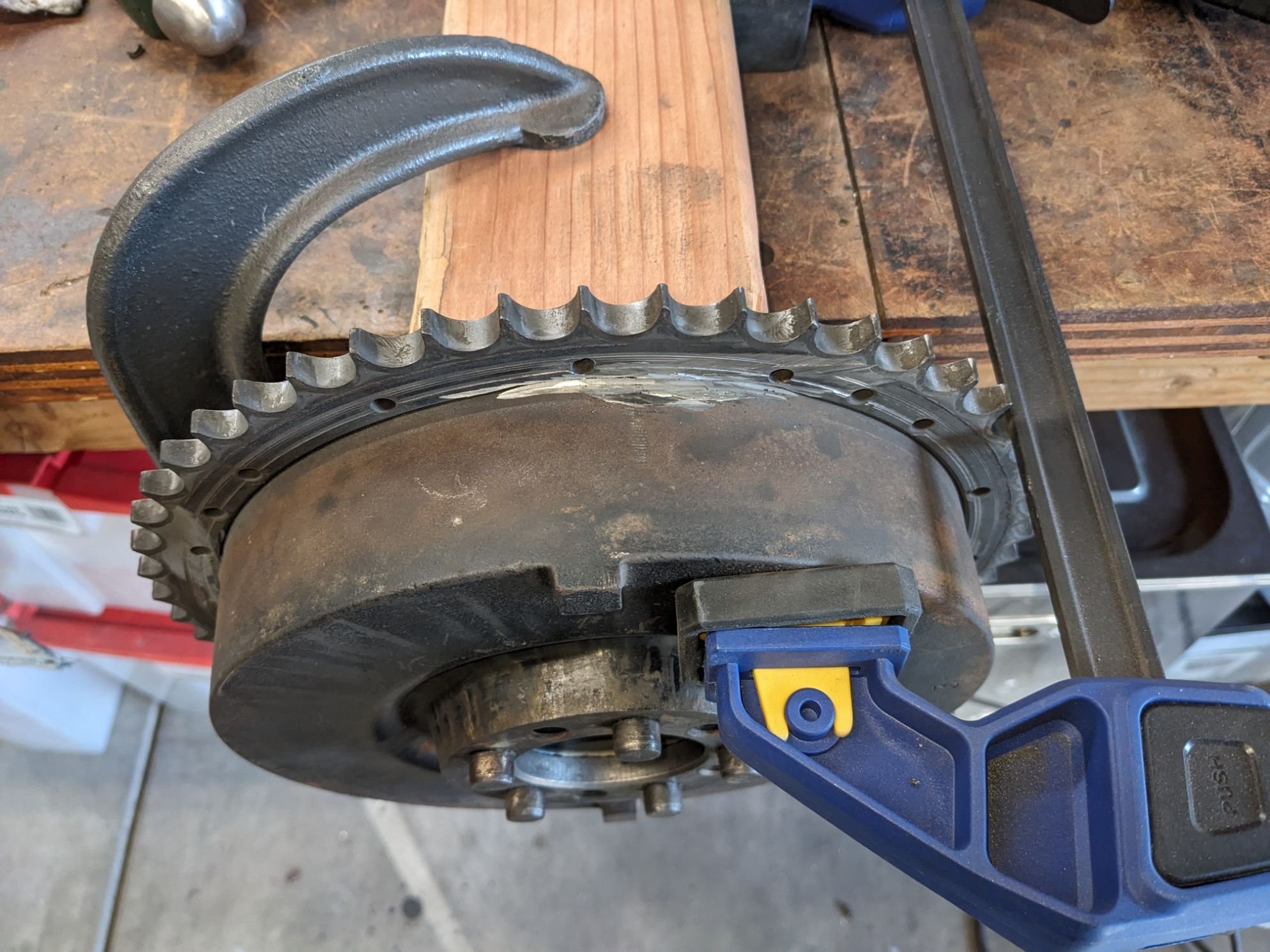

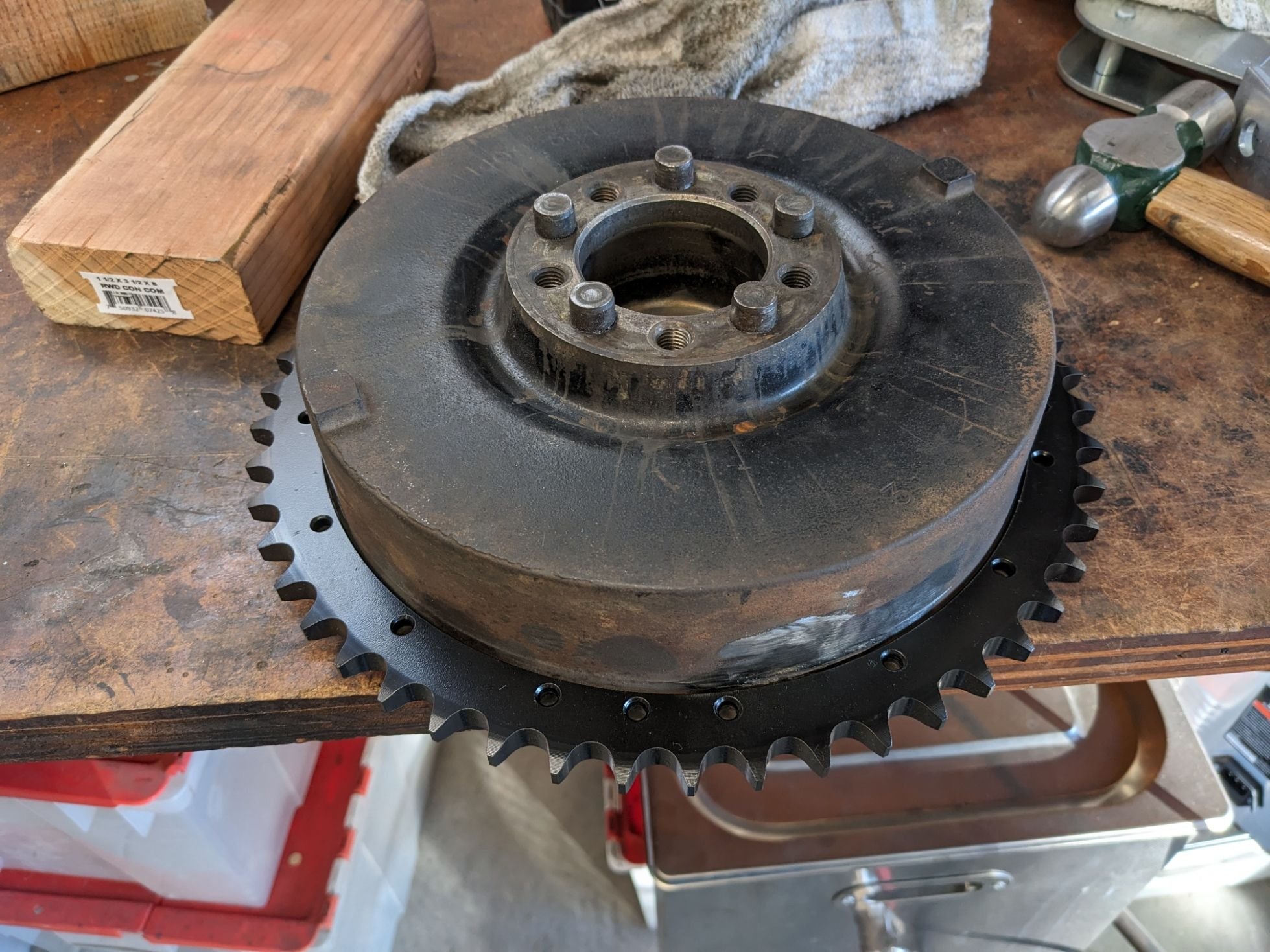

Doing the rear wheels and brakes on the 65FLH.. The rear sprocket needs changing even tho the chain is new. Don't want a chrome brake drum / sprocket so I'm replacing the sprocket on the current drum. Drum measures 8.005" so it's salvageable. One problem is that the sprocket is welded to the drum in 4 places.. I was able to get the old sprocket off.. After riveting should I weld the sprocket in place? If so what welding rod? The old stuff was likely stick welded and supper hard. 7018, 8018? I can mig it or tig it.. I'm thinking ER308L or ER312L and tig..

I dont think the factory did anything more than rivet them on. I dont enjoy replacing sprockets, haven't encountered a welded one so far thankfully.

That may be the way to go. Have an old Snap-On air hammer and a rivet die for it.. I can set the rivet pretty well.. It interesting that I find tools in my tool box that I'd hadn't used for almost 40 - 50 years and they are getting used.

we heat the rivet red then set it - yea but it works for me and shorten them as well
and if the drum is worn well but till usable we weld it on its no good 10 years from now anyway - have also cut an old sprocket off a good drum and did it again

In aircraft work I sometimes use 3/32, 1/8 and sometimes 5/32", however they are aluminum.
The pneumatic squeezer and 3X pneumatic rivet gun I have would never work on steel this size.
Looks like that expensive tool is only a jig with a hand set die punch.
I would figure a way to hold the drum and find a good die punch as that would save a ton.
Heating the whole rivet almost red before dropping it in the hole will make it much softer.
Assuming that is a 1/4" rivet, this one with a hammer and a hot rivet should work. It is made for a pneumatic gun but for the price you could beat it up with a hammer and throw it away.
