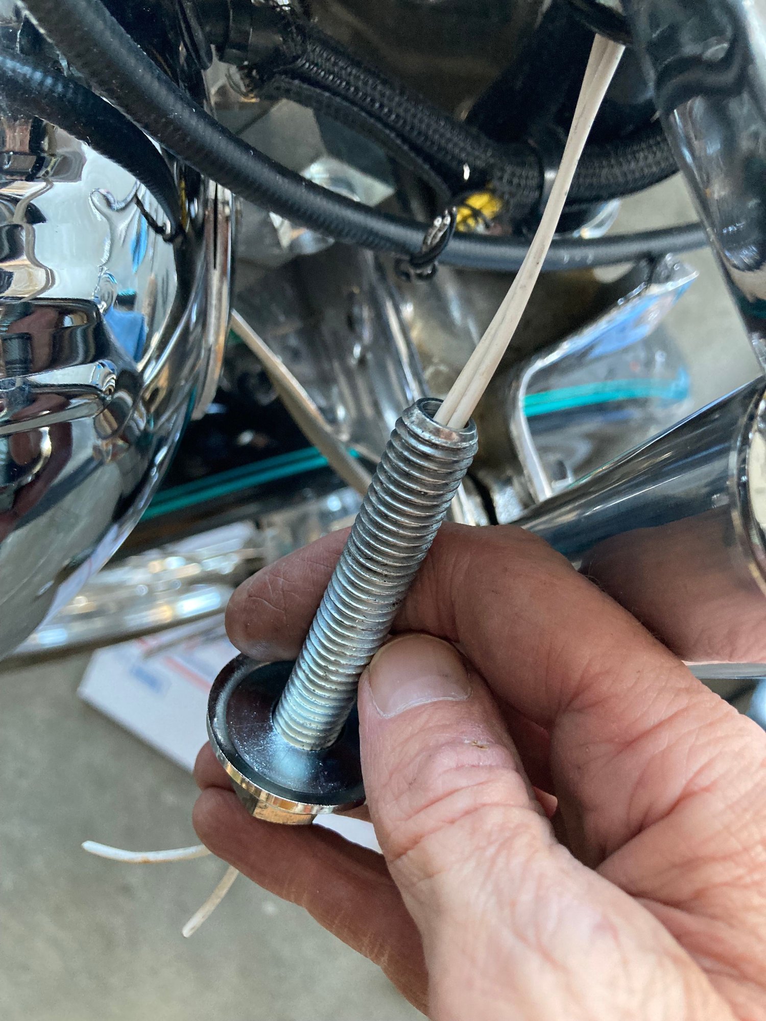

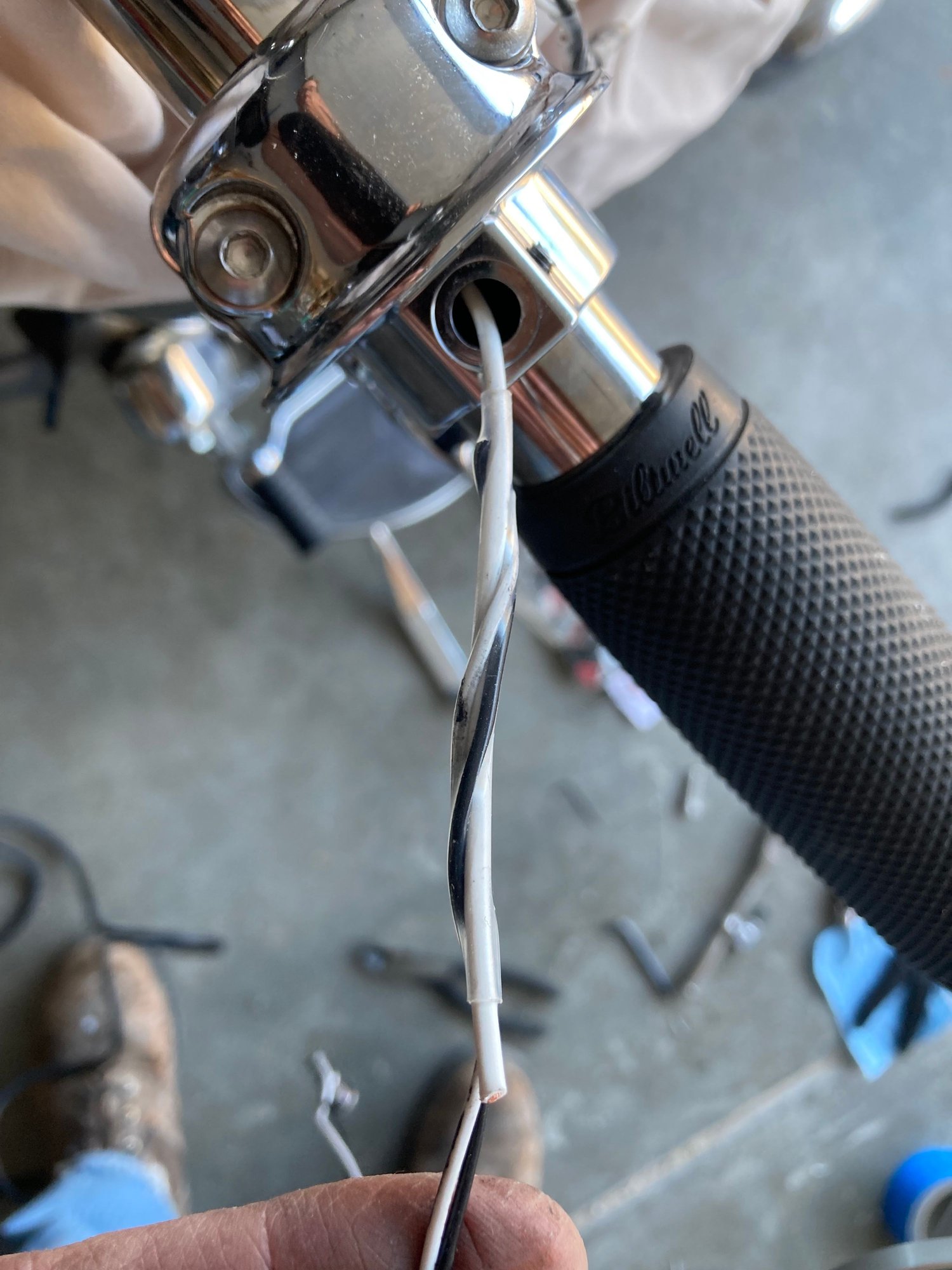

Here are a few shots of threading the wires through the bar and hollow riser bolts for the aluminum momentary buttons I chose. They're quite small but work fine--especially with unlined leather gloves. A bit trickier with winter gloves (though I don't often ride under 50 F)... I temporarily used (clear) shrink wrap to pull the leads through the bar.

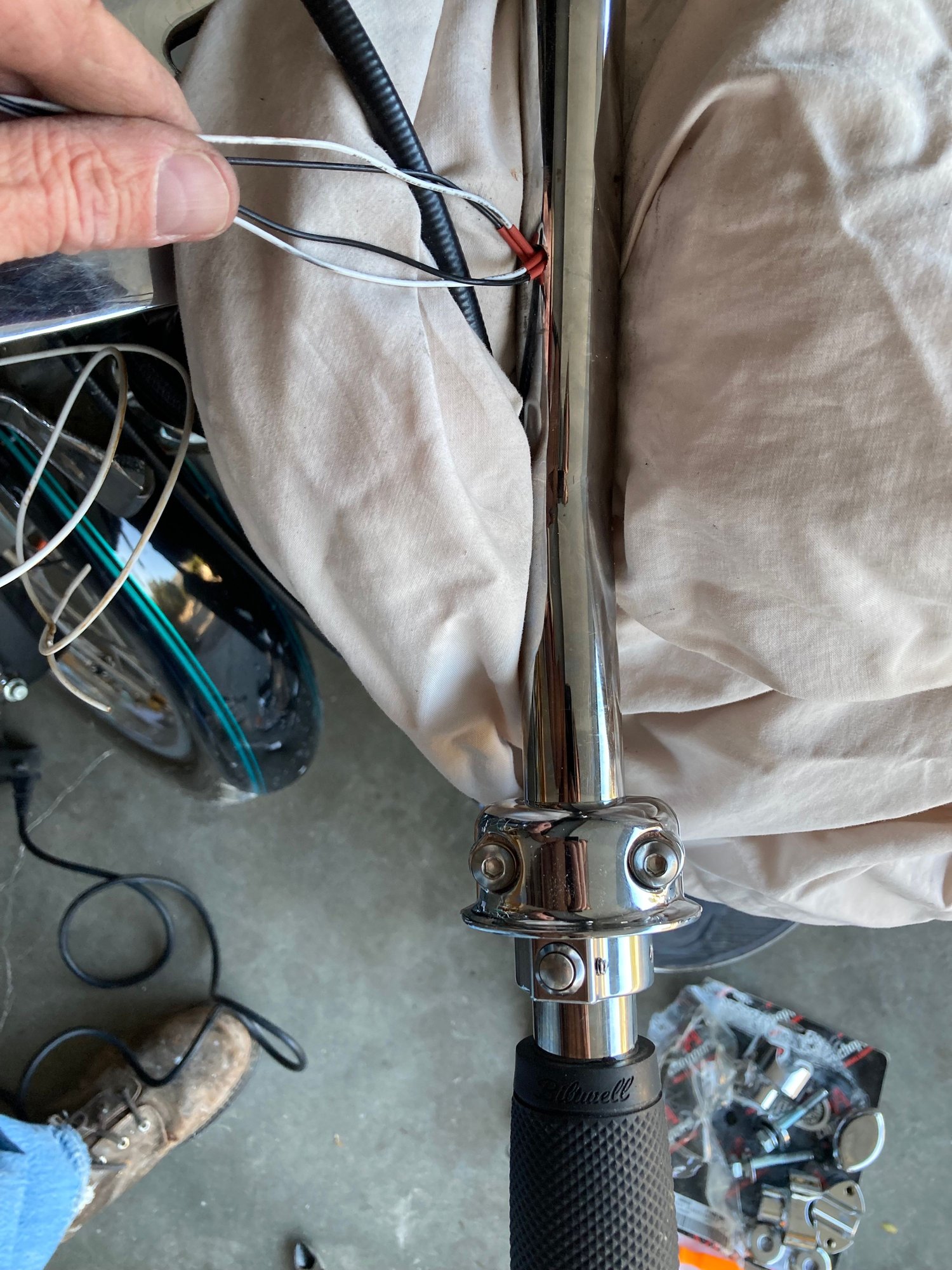

So, I ran down the road to the post office, and... sure enough, the professional rebuilder was right: even though made in '67, it's a 1:1 unit, as the needle was reading roughly twice as fast as it should've, judging from seat-of-the-pants impression putting down a route I've ridden a bazillion times. However, the needle floats smoothly, and the odometer barrels advance as they should. Pretty cool--and I really like the way this vintage unit completes the bike's aesthetic.
That said, I looked again at the Colorado (auto) speedo expert's website, and I didn't realize he can provide a ratio reducer that will easily accommodate this error (I had thought it was only up to [x] percentage).
Based on the distance, it's looking like I need a reduction of just under 50% (weirdly, as I have a 25-tooth tranny sprocket), but I don't trust the navigation system's guesstimate in the car of 2.3 miles--and the electronic odometer doesn't read tenths of a mile (for crying out loud). So, I've asked my machinist (whose shop is next door) to run down to the post office on the way home to compare to this round-trip readout (1st pic).

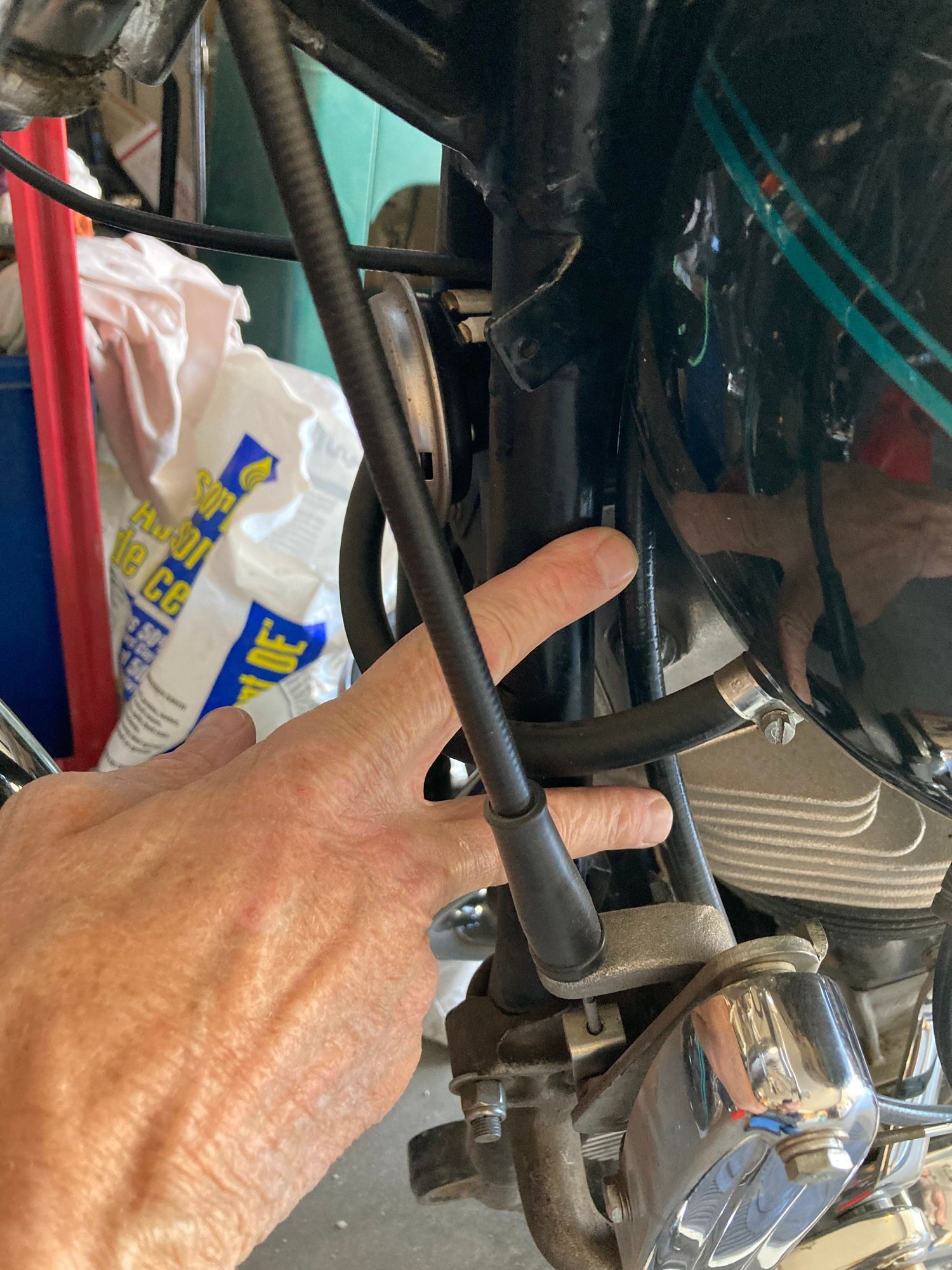

Then, I'll have to figure out where to put the cigarette lighter-sized ratio adapter box. I would like to hide it between the tanks, but with the ferrules and threaded collars, I'm afraid it'd create to long of a straight and inflexible section in the cable. So, may have to put it just below the tank as indicated...
