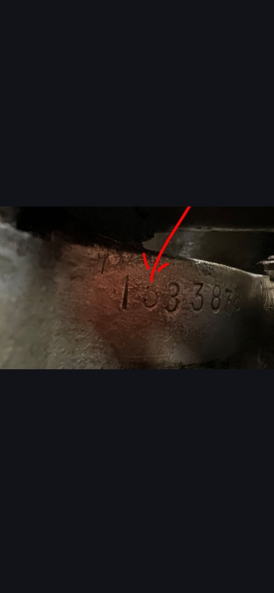

Looking at acquiring a 63 Duo. Have concerns with VIN and bellies. Right side belly #s look good. However, left side belly #s seem to have correct font, but do not match the right side and the 8's look upside down. VIN and boss look rough, but the fonts appear correct (although the 6 is rounded instead of serif). Cases were painted and the speedo cable had been rubbing across the VIN. Bike is clear titled with the VIN. Bike runs and has a '62 date coded trans. Left case could be a restamp. Looking for opinions on if Dr. Frankenstein has operated on her.

A clearer photo of the R-H BN would have been a good idea but it may be okay. Especially notice the year 3 appears to have a round top and that’s what I’d expect.
But in the left BN the year 3 has a flat top and that is not consistent with factory stamping.
I’m wondering if someone stamped 0 in the left BN because they thought the R-H BN had 0 in that position when in fact the R-H BN has 6.
I’ve seen upside-down 8s before but in this instance it’s unusual for them to be like that in one BN and not the other BN.
I suspect the entire left BN may be non-factory.

In your photo the sequence portion looks like 7002? If so it complies with the 60–69 even-odd code but all four characters appear to have problems.
The 7 appears to be sans serif but in my example the 7 is seriffed. Also notice the back is different.
Notice the 0s appear rounded when for 63 I’d expect them to be oblong in shape.
Regarding the 2, it looks like the horizontal stroke has a diagonal stroke at its end when normally there would be a short vertical serif there for 63.

Thanks Eric. Think I'm gonna pass. Too many anomalies. Really appreciate your response!
