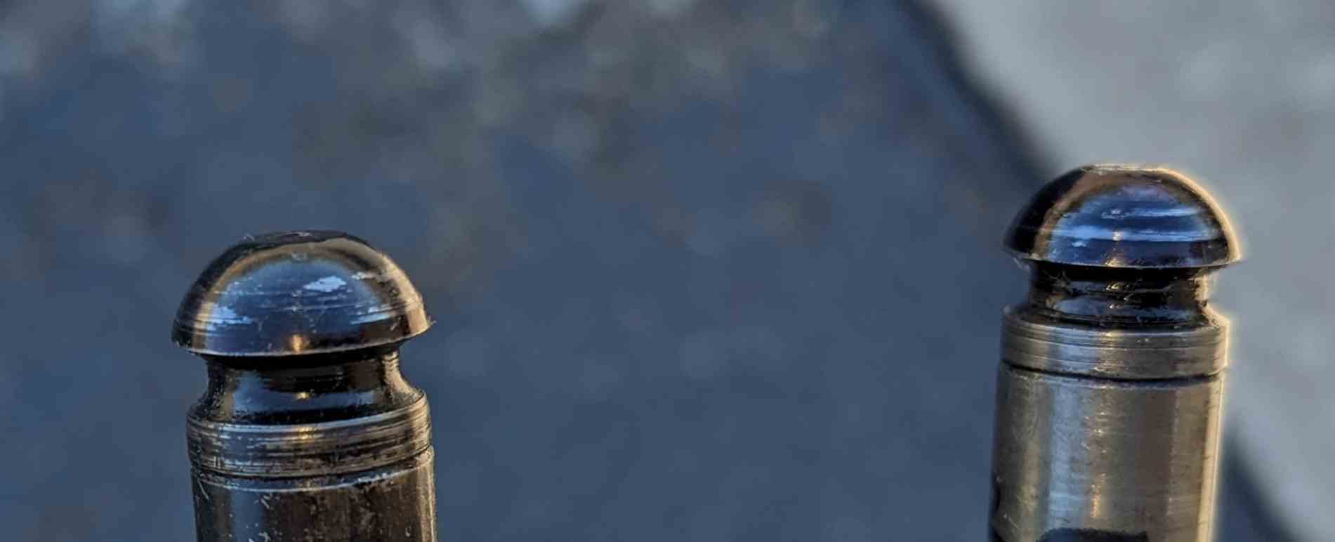

I'm not sure why you show the pic of a lifter for what looks like an early pan. The main problem is that this motor had oil passages blocked and the pushrod ends wore quite a bit. I replaced the rocker blocks and arms.
https://www.hdforums.com/forum/panhe...l#post21549291
I was rebuilding the pushrods on this latest teardown and found that the ends were worn. Notice the end flat on one is a lot smaller than the other. The radius of the end is not concentric with the centerline of the pushrod. One the one with the small flat, oil fed to the rocker cup can leak out.. I suspect that it's due to the pushrods wearing into the rocker arm sockets without oil.
Sorry about that Max. I guess I had lifter on the brain as there was a post about lifters I was posting in.

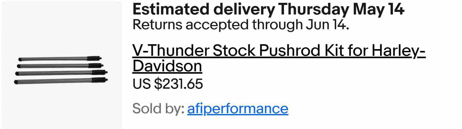

I found from V twin mfg some 11-7706 53 to 65 V thunder pushrods that are chrome alloy instead of aluminum. When I ordered the set, all other listings stopped so it may have been the last set. The only other steel sets are S&S which the going price was around $400 without adjusters or nuts... WFO Larry has a set of Jim's but they turned out to be for a shovel. The Jim's ones look to be aluminum. I'd probably gone with colony aluminum ones but I'd give these a shot. They may be the last set as I'd bet comp cams don't make them any more..
