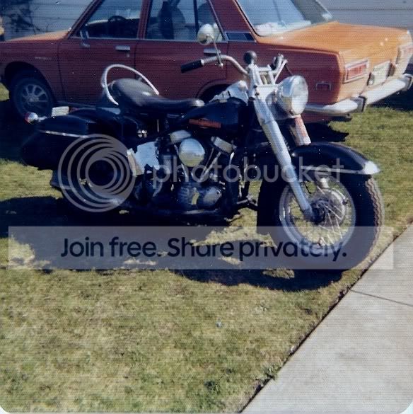

are those the same as the shovel manifolds for rubber bands? I think they run like 30 bucks? This thing is gonna be a ton of work, I gotta convert it over to 12v, eventually replace the tins, fix a shifter fork, probly buy a new chain/sprocket. it'll be fun though
here is a picture of it in the late 60's early 70's
