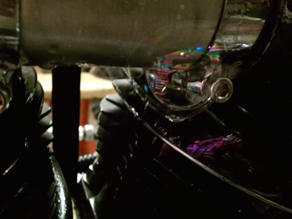

Hooked up the tester this morning:
Checked my seals to make sure they were nice and tight. They are and not kinked or caught:
That gurgling noise I heard was not my grand daughter blowing bubbles. It was the rear jug making that massive blowing sound:
Leak is towards the bottom. I cannot figure out exactly how as the seal is in right and seem nice and tight. I know it's not the nipple, definitely the seal:
Now all I need to do is figure out what to do now WTF???????? over.

Those clamps are really nice looking but I've seen a lot of posts on different forums taking about how they they tend to pinch the o-rings and leak.
If you keep having trouble trying to seal it you might want to try some stainless aircraft style clamps like these...they are pretty cheap, not as pretty, but seal pretty good.
One more thing...looks like you have standard rubber o-rings, nothing wrong with those, but the crap gas we have to run these days eat them up over time. They'll last, but if you have to pull it apart you might consider viton o-rings instead...they hold up to all the additive crap in the gas a lot better.
Also, not sure if your bike is just a different set up...but here is a picture of my intake before I cleaned it up with the old clamps pushed to the side...the way my o-rings seat from the intake to nipple looks a lot different than yours. It almost looks like yours is set up for the rubber band style seal with that up-notch from the o-ring area on your intake. Mine is the same size...nipple and intake. Take that with a grain of salt as I am very new to these old bikes.

WOW, took a little bit, but finally got her squared away. I'm a happy camper today
Upon close examination of my intake, I came to the conclusion it can probably swing both ways, O ring and rubber band. It is a ZEL intake. Not an S and S.
Soooo, I went and ordered me a set of the band type aircraft clamps. I got them this morning.
It's a great day, as I had redone the S and S super B with original S and S float and needle, and got the heli coil in the oil return cover so it didn't leak like a spaghetti strainer.
After almost two hours of fitting and cursing, fitting and more cursing, I got this beast together. What a PITA.
I discovered that the rubber band, AND the O ring will fit. I was going to try and take pictures of everything along the way, but got caught up in getting this thing together.
The fit was already tight, so getting the bands on there, and then the clamps proved to be quite a chore. Had to do a little bit of fitting on the clamps (for us in the sticks fitting means grinding and a big rubber hammer)
But I got em on.
After getting everything back together I ran the vacuum check and was surprised to see bubbles everywhere.
Well, I started to crank down on the clamps, and crank down, and get nervous, and crank some more. Finally the leaks stopped.
Seemed like I had to get those suckers awfully tight. But they have both seals in them now, O ring AND rubber band, and I have no leaks.
I lifted my enrichener, gave her three kicks to prime, put the circuit breaker in the middle, switch on and one kick.
Got a snort, chuff and puff of smoke.
Kicked again, and whooo hooo, she fired right up, dirty wench that she is.
Thanks to all for the great advice and pictures.
