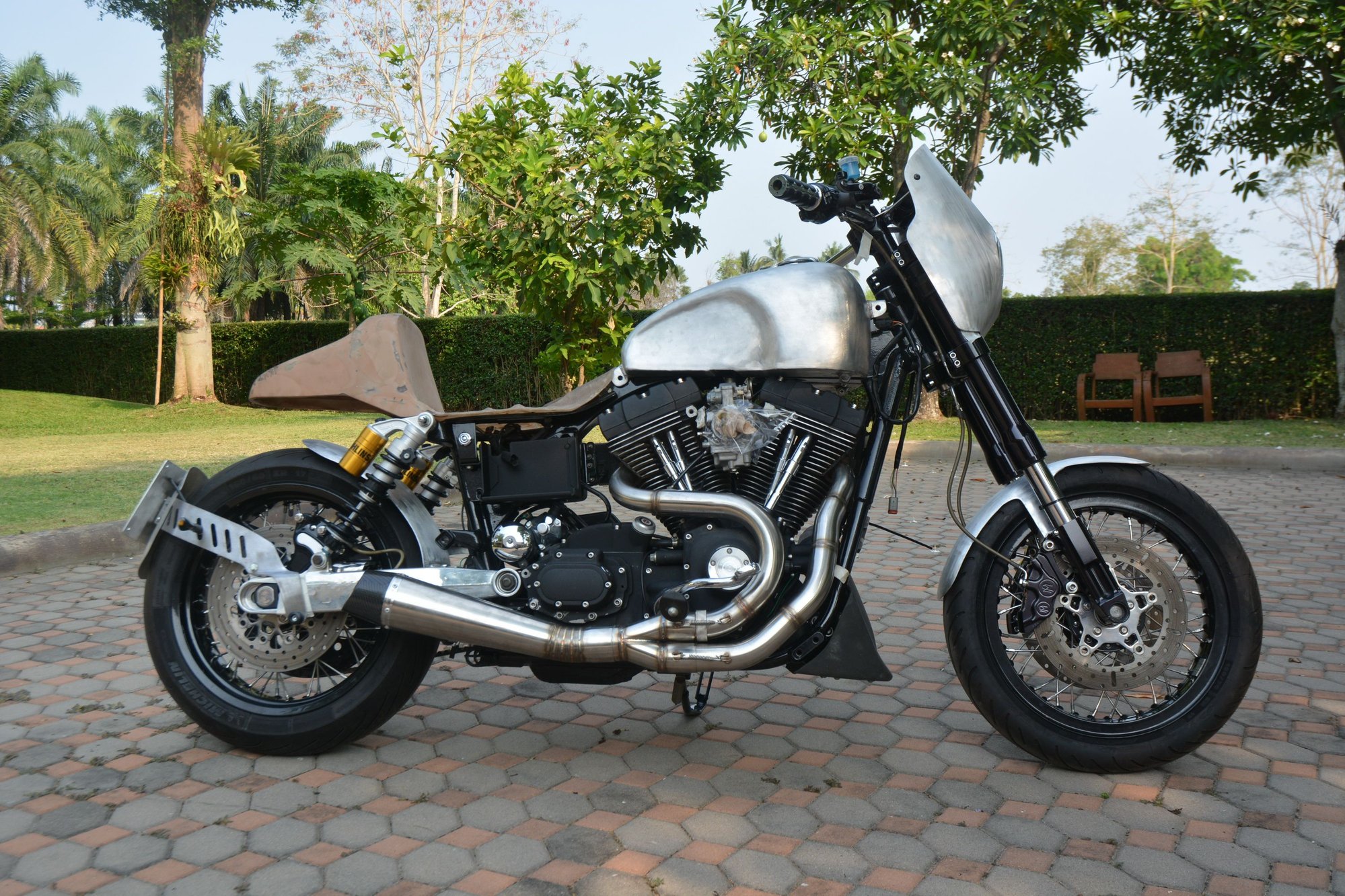

It is still in the mock up stage and some bits are missing as you can see but this will give you an idea

That is a good looking machine! I would also talk to a paint shop about a high quality sati . Wax/sealer would work too, but you would spent a lot of time cleaning, especially around your swing arm.

I used an original Superglide boat tail as a mould for the back half of the fibreglass tail piece, but now thinking to use it as a buck to do it all in aluminium. Same buck thoughts re the fiber chin spoiler, which I had to make larger to hide the Tru-Track chassis stabiliser

I love the look!! That bike looks great!!
