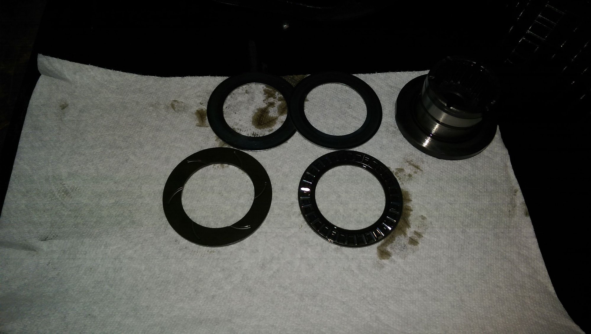

I've got the latest SE comp in my 07 EGC. It probably have about 40000 miles on it. It's beginning to rattle some so I plan on trying the PEEK thrust washer from the M8s. It's about 0.020 thinner than the needle bearing and I'll check / adjust the sprocket spacing and add one of the 0.030:" spacers. I'm hoping the PEEK washer will provide a little more damping of the comp rattle.
Last time I assembled it I used 2 or the small Belleville springs cupped to control the rattle. It worked well for a while but think I might need a little more pressure. IIRC someone here said they used one of the second springs from an older SE comp in place of the small spring. Anyone doing this? BTW, Spokes and cam still look good.

Here are some pics.

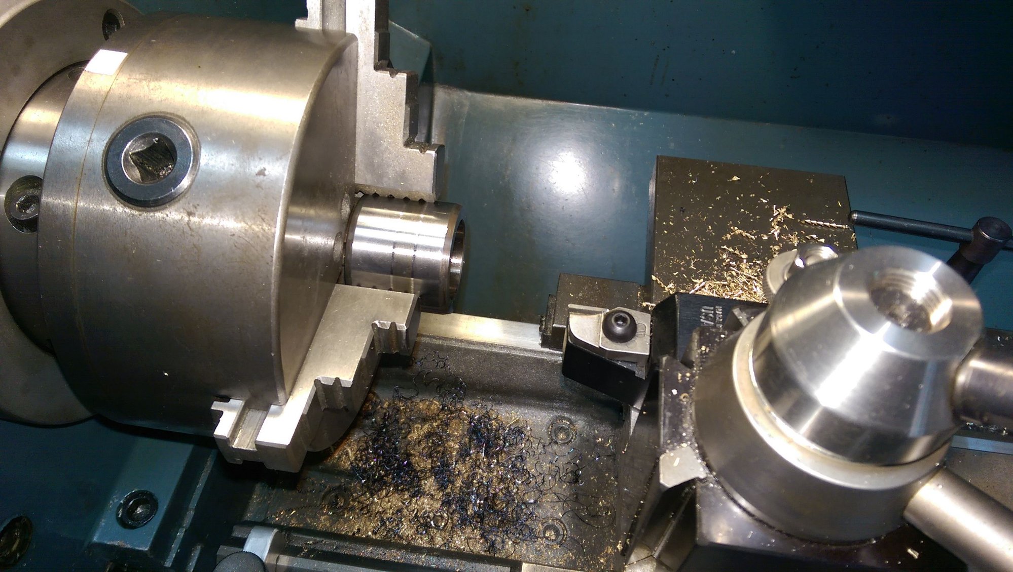

With the motor having over 100K on it. Runout is about 0.004" on this side. Original tensioner still looks good. Replacing the thrust bearing with PEEK washer out of an M8 I trimmed 0.020 off the engine to get the alignment back.
