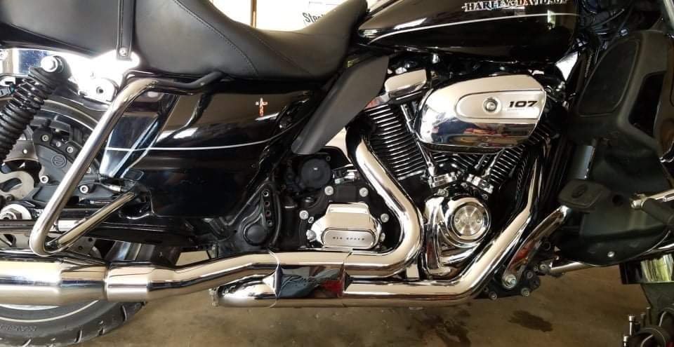

In 1st gear and locking bar between primary sprockets worked perfect!👍
Should have it on test ride after exhaust and floorboards install.
Sure didn't hold very much fluid in primary.🤷‍♂️
Bike was straight up on stand and it filled to bottom of clutch basket with less than a quart. Will recheck after a ride and it settles down.

Test rode her today about 30 miles and she shifts and acts perfect and everything is completely dry so far. Ran Mobile1 Vtwin 20/50 in tranny and once returned (30 miles) and let it sit a few hrs, I drained tranny (magnet and oil was spotless) and now have the Bel-Ray 85/140 and will see if a difference tomorrow.
All that is left is installing saddlebags and rear floorboards.
Shout out to "Stone Cold" for shipping me a transmission gearset at a great deal and words of advice!
Installed a new shifting drum because of different neutral detent position, an "All *****" output shaft bearing in the inner primary. That and all new gaskets cost much more than the gearset.
Compared to the 4 speeds I have rebuilt these 6-Speeds truly seem simple as pie and straight forward with a great design but from what I have seen 3rd gear has been a weak link for a good while now.
This 107" 2017 Ultra truly runs its *** off as it so easily pulls up front wheel with just twist of throttle in 1st gear with an S&S 475 which from reading isn't supposed to be that good on the the lower end....🤷‍♂️
