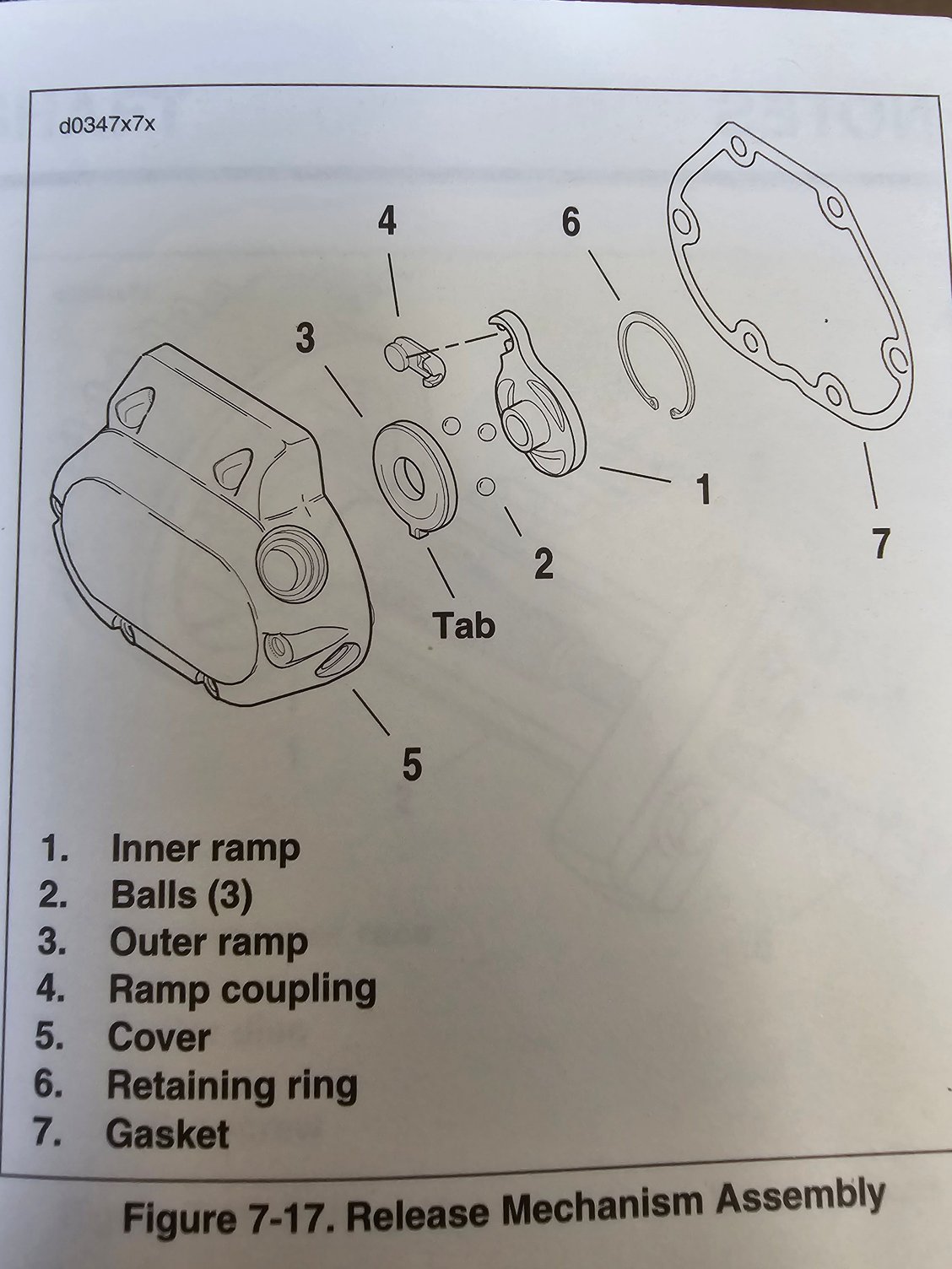

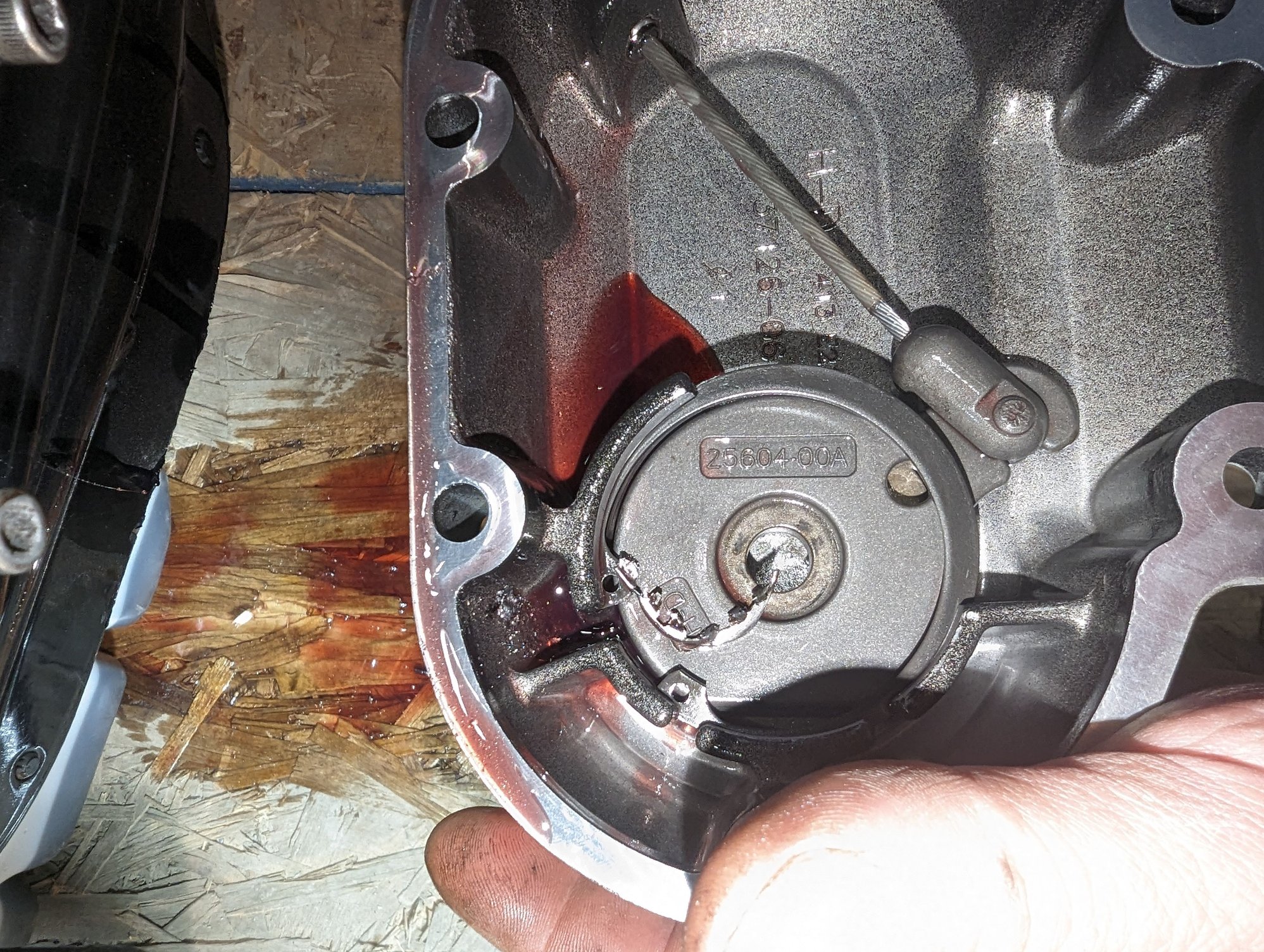

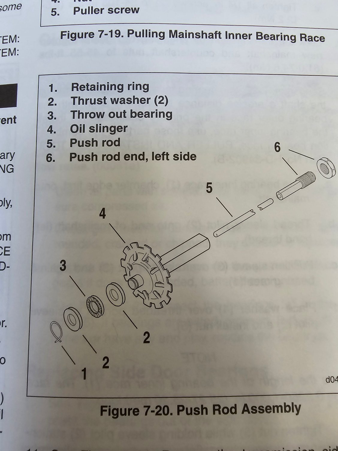

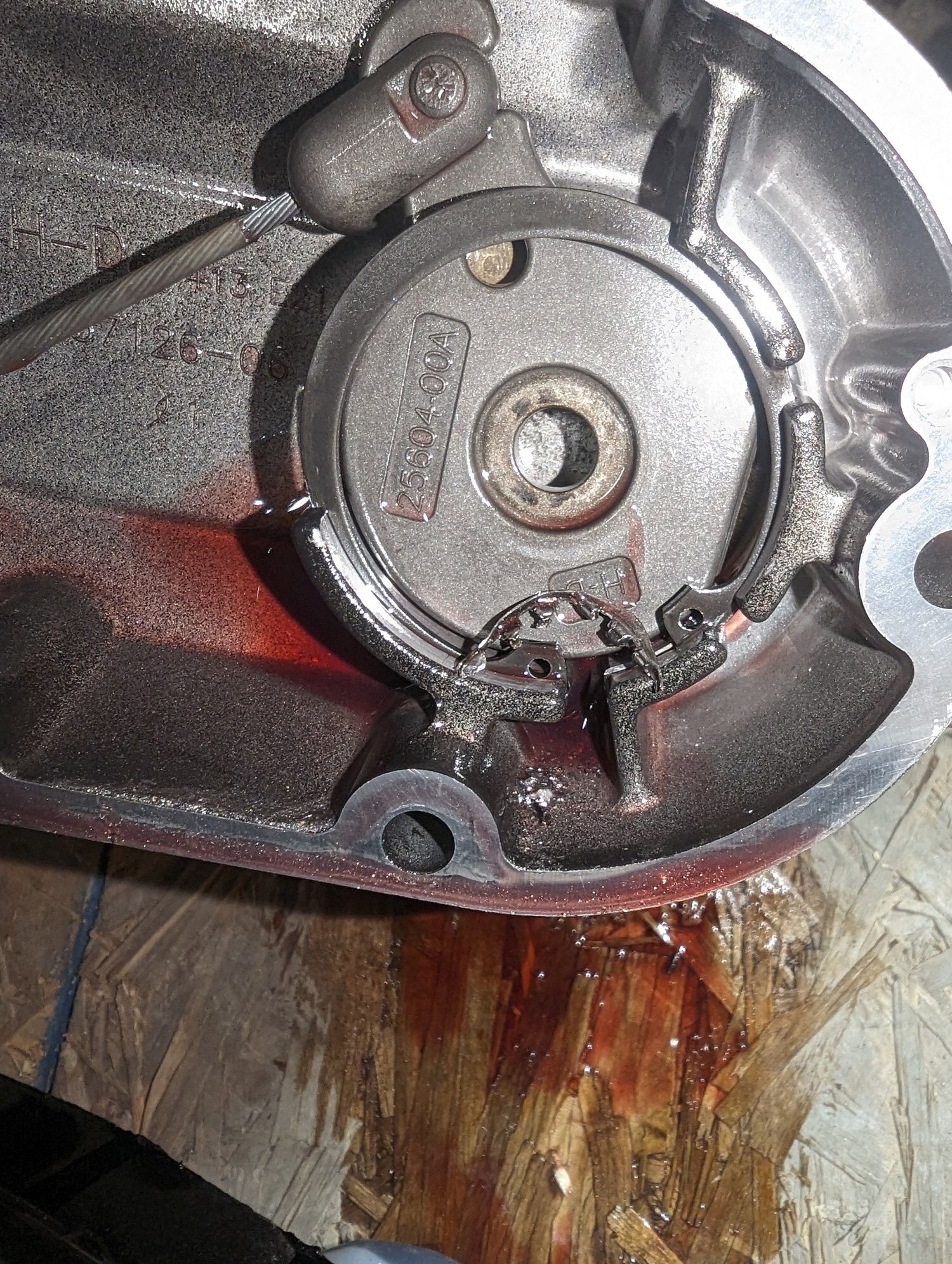

Okay...so I had a local shop install a Barnett scorpion clutch pack in my '16 Dyna wideglide. From now on I'm doing all my own wrenching, but moving forward I have about 1000 miles on this clutch and it feels good. But the other day I grabbed the lever and it came straight back and touched the bars with absolutely no resistance, cable is not broken. I removed the exhaust and transmission cover on the right side and this is what I discovered. In the clymer service manual I can't even find this part. Does anybody know what happened? A friend of mine said a pancake bearing but I don't see where it would go. Any help would be much appreciated.

Looks like your retainer ring popped off. Clutch throw out bearing. Think what your friend is calling a pancake bearing. Proper name is thrust bearing.

I don't know what that debris is but it's not the "retaining ring"/spring ring. It's clearly in the proper position in the first pic, the gap in the ring is even straddling the gap in the case as it should.

Snake..Though saw I saw eye of retainer also in groove. Looks like someone stuck extra retainer on. When it self-destructed, all the free play occurred.

​​​​​​IM assuming it's black from the bearing getting hot???
