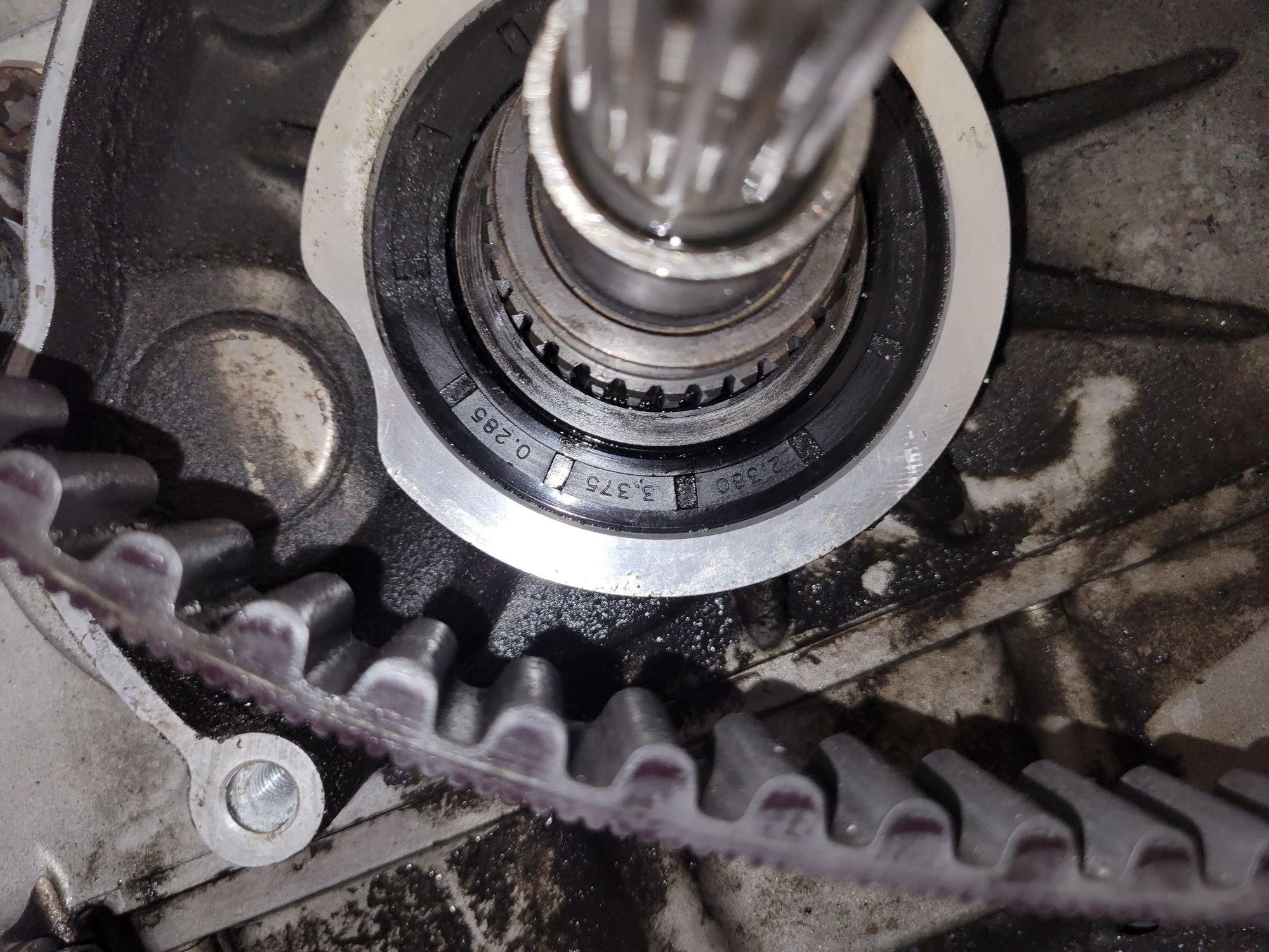

So 2 years ago I upgraded to the Baker 6 speed double tapered roller bearing and am now regretting it. The issue is the main drive seal is prone to leaking and it is only available from Baker which is not even listed on their website. I'm just wondering if anyone has found another seal that works. BTW the 12074 seal is too wide so it must have the following dimensions 2.380 x 3.375 x 0.285.
