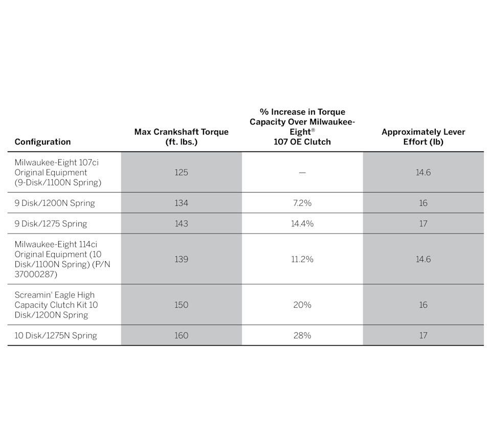

So while doing some research, I found out some information. Springs are rated in "N" ratings
The HD website shows these 2 springs for every year bike from 2017 to 2026
HD SE 37000288
Milwaukee-Eight Engine Clutch Springs - 1200N
HD SE 37000286
Milwaukee-Eight Engine Clutch Springs - 1275N
2017 - 2026 both can use the 1200N and 1275N Springs

>The N rating (or N/mm) for springs represents the spring rate, indicating the stiffness or force (in Newtons) required to compress or extend a spring by one millimeter (N/mm)

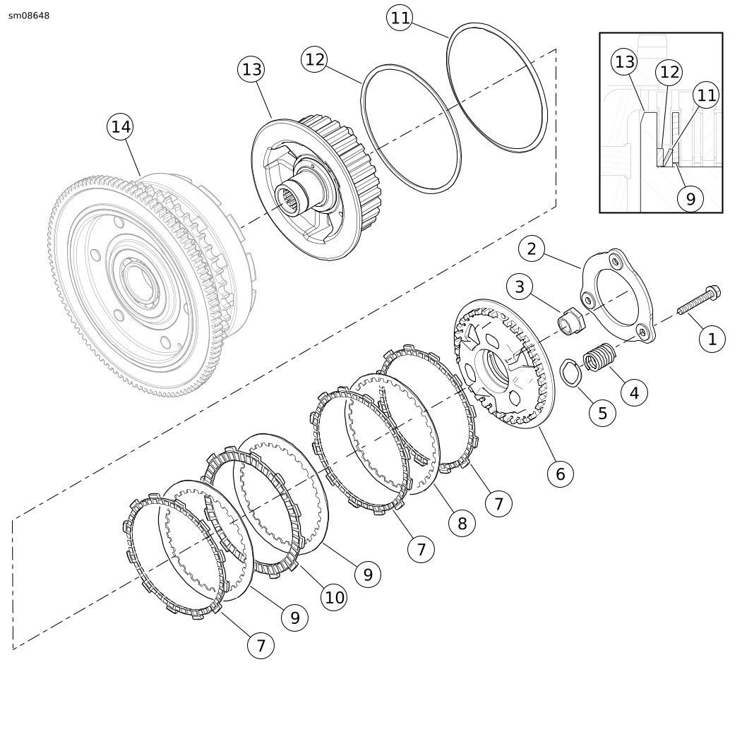

Replacement clutch springs for the Screamin’ Eagle® High Capacity Clutch Kit P/N 37000287.
Kit contains 10 fiber clutch plates (one more than Original Equipment), 10 contact plates, and 3-1200 Newton clutch springs
Installation of these springs with Original Equipment clutch plates will increase clutch capacity and lever effort
Can be installed without removing the outer primary cover
Kit includes three 1200 Newton (N) coiled clutch springs
Designed to complement the Screamin' Eagle® High Capacity Plate Kit P/N 37000258
Installation will increase capacity and lever effort
When combined with the High Capacity Clutch Plate Kit, torque is increased to the maximum level available
Kits includes three 1275 Newton (N) coil springs
