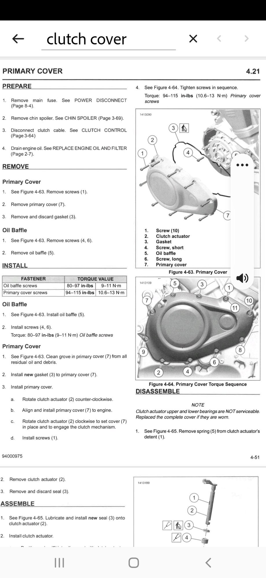

Does anyone know how to remove the black clutch cover on the nightster 975, I’m trying to install an aftermarket medallion.

sorry its so blurry- its a snapshot of a pdf

I was curious if you were able to get the derby cover off..and if so how did you do it. I have looked the diagram over a few times and still no understanding how the come off..any help would be appreciated
