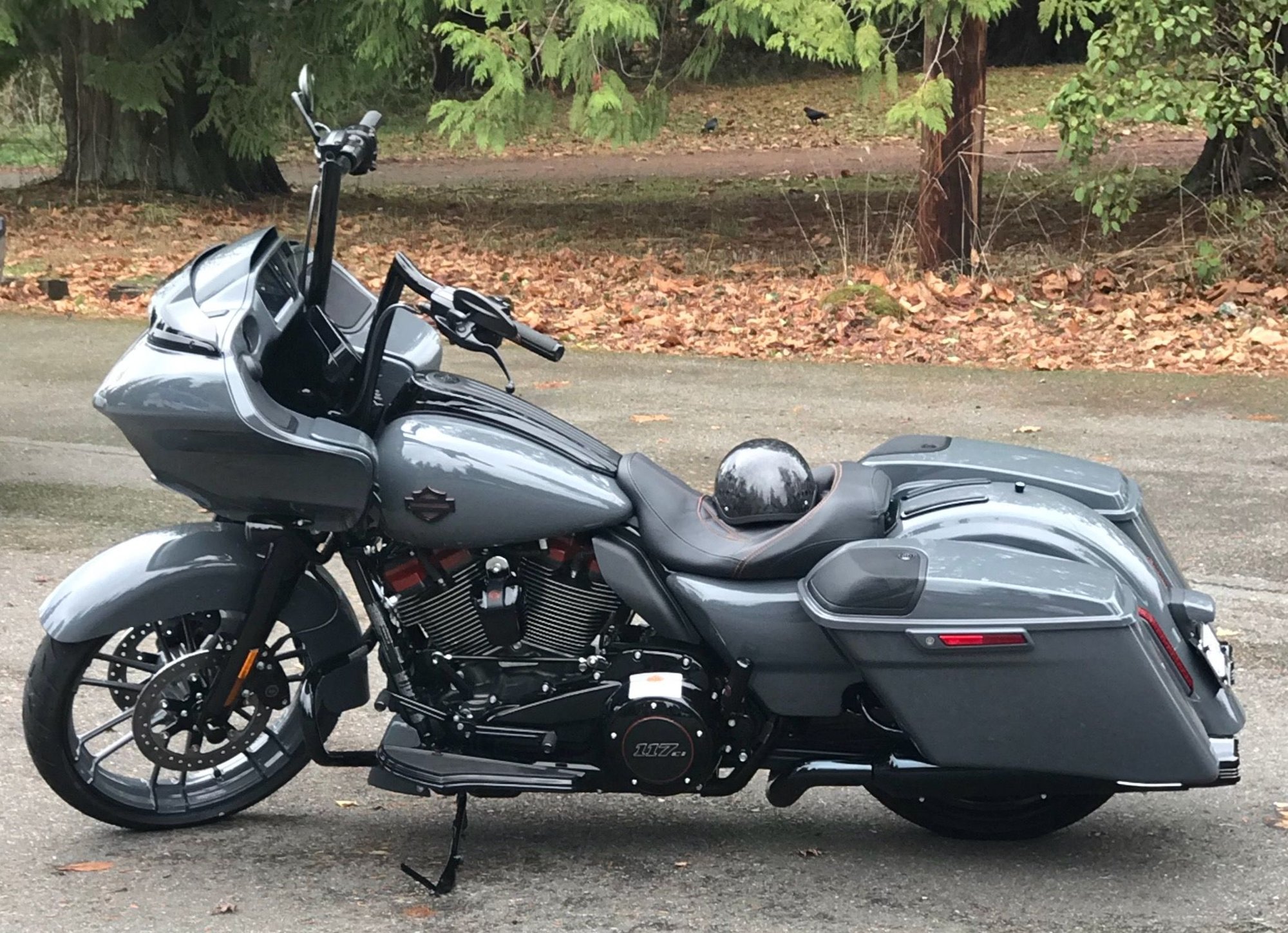

Sharp bike. Did you go with F47 or yaffe, can't tell from the pic. If 14", did you stick with stock cables?
Old Dec 24, 2017 | 07:58 PM
7Sixpack7's Avatar
7Sixpack7
Posts: 309
Thanks!
14” F47. I went with +4 clutch and brake lines. They say you can use the 14” and not change the lines. I preferred to have the lines remain in the stock locations. YMMV 🍻
