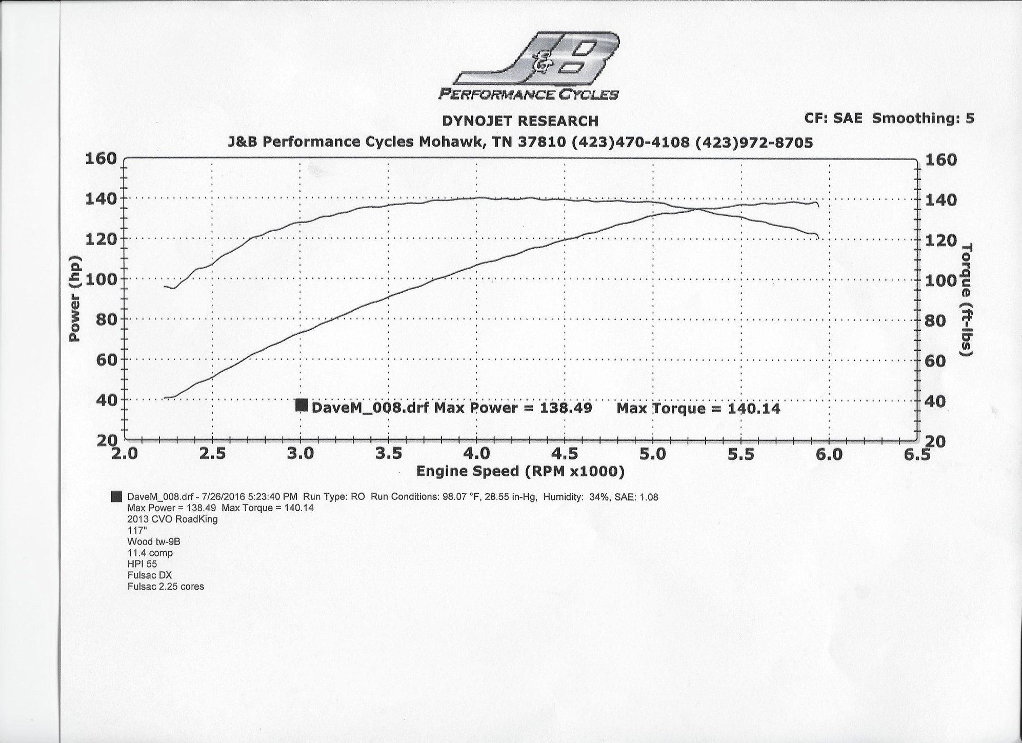

Originally Posted by FLSTFI Dave
Harley 117 Kit is okay, not great. Main reason is the 259E cam needs more compression then the Kit has. Compression should be very close to 11.0 for that cam.
Many well know builders have nice 110-117 kits for the motor that make more power or torque, and comes on in a better area of the power band.
My 2013 CVO King is a blast to ride, and very reliable. Way more power then the HD kits. Torque comes on early, where you ride and its a nice long flat curve. Its been ridden from TN to Key West, to Apostle Islands in WI, Fayetteville AR and so on.

Originally Posted by deez nuts
Looks like you have a nice setup there. I also have really never been impressed with any of the Screamin Eagle kits. Seems like the performance to dollar ratio isn't in balance. For whatever reason the SE kits just don't seem to lay down big power and I speculate they're a little tame for warranty reasons or something
Its a fun easy to ride bike, plenty of power. I would say your right on H-D kits tame for EPA and warranty.
