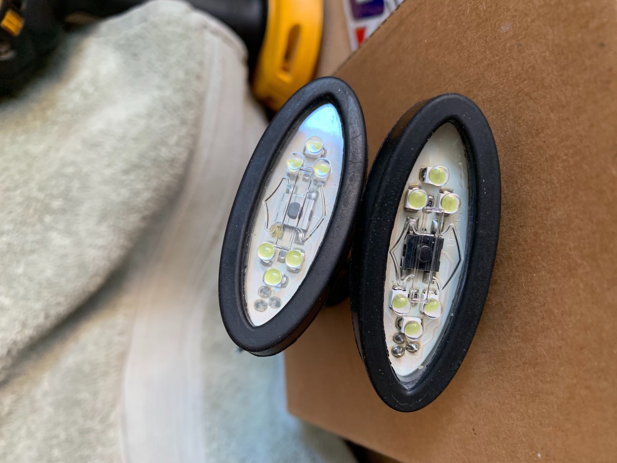

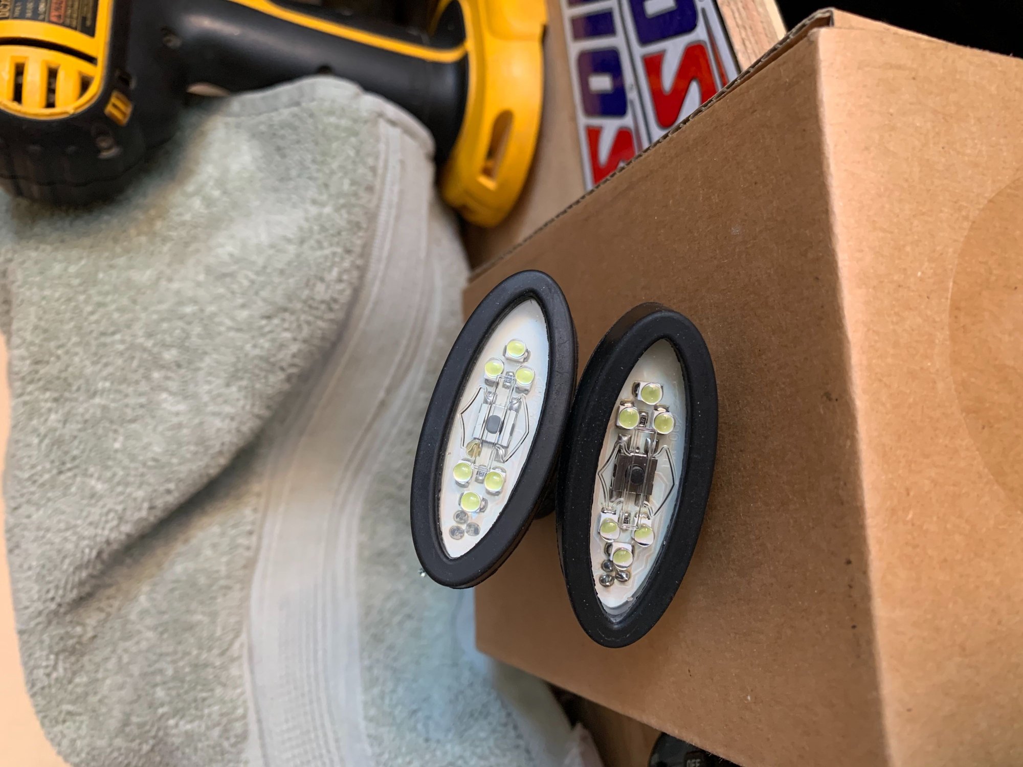

you can buy them separate as a replacement part
I just got 2 for the exact same reason I had 1 that didn’t work at all and 1 with only have working
i can look for the part number

Here you go #38 part number 68000066

Yes very easy to change just remove the tour pack liner and each one has 2 nuts
