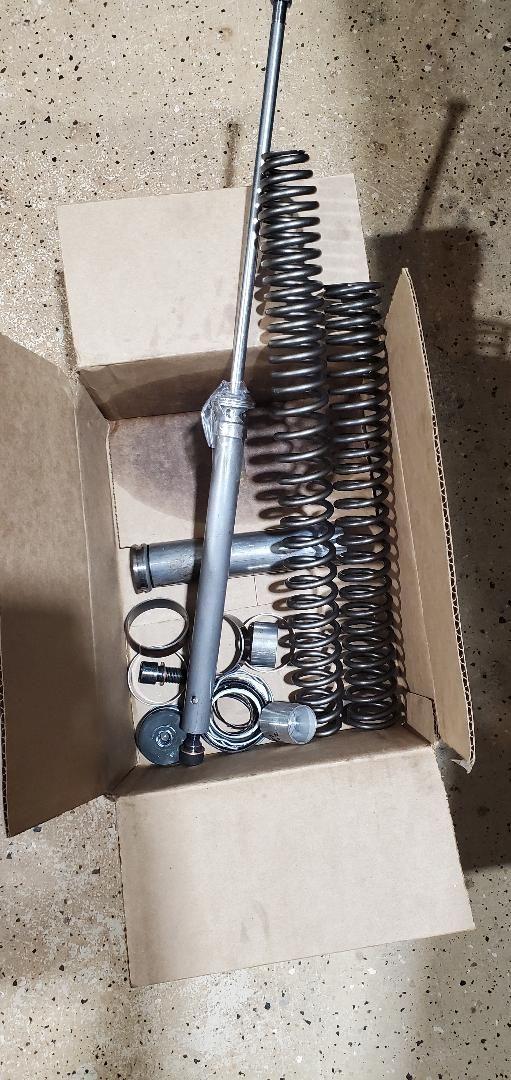

Update: I purchased the Pro Action 49mm fork kit and am in the middle of the installation. The right fork is finished, now I'm working on the left fork. "Discovered" the left OEM fork has a cartridge in it, so I had to purchase a few OEM parts to complete the installation: i.e. fork bolt (for top of the fork), a rebound spring and the oil lock piece (the "cup" that the damper rod bolts into). The Pro Action tech support has been great. Will update again, once the parts arrive and installation is complete. Attached pic of front fork assembly, that shows difference between the right and left fork, and the reason I needed to buy the OEM parts.

Update: Installation is finished. Test ride went great. Bike handles infinitely better in turns, over bumps, during braking & accelerations. Gives the bike a real solid in-control feel. Attached a pic of the Pro Action Fork Kit.
Also embedded a pic of the old OEM fork parts in a box - you can see the OEM springs are way different than the Pro Action springs.
