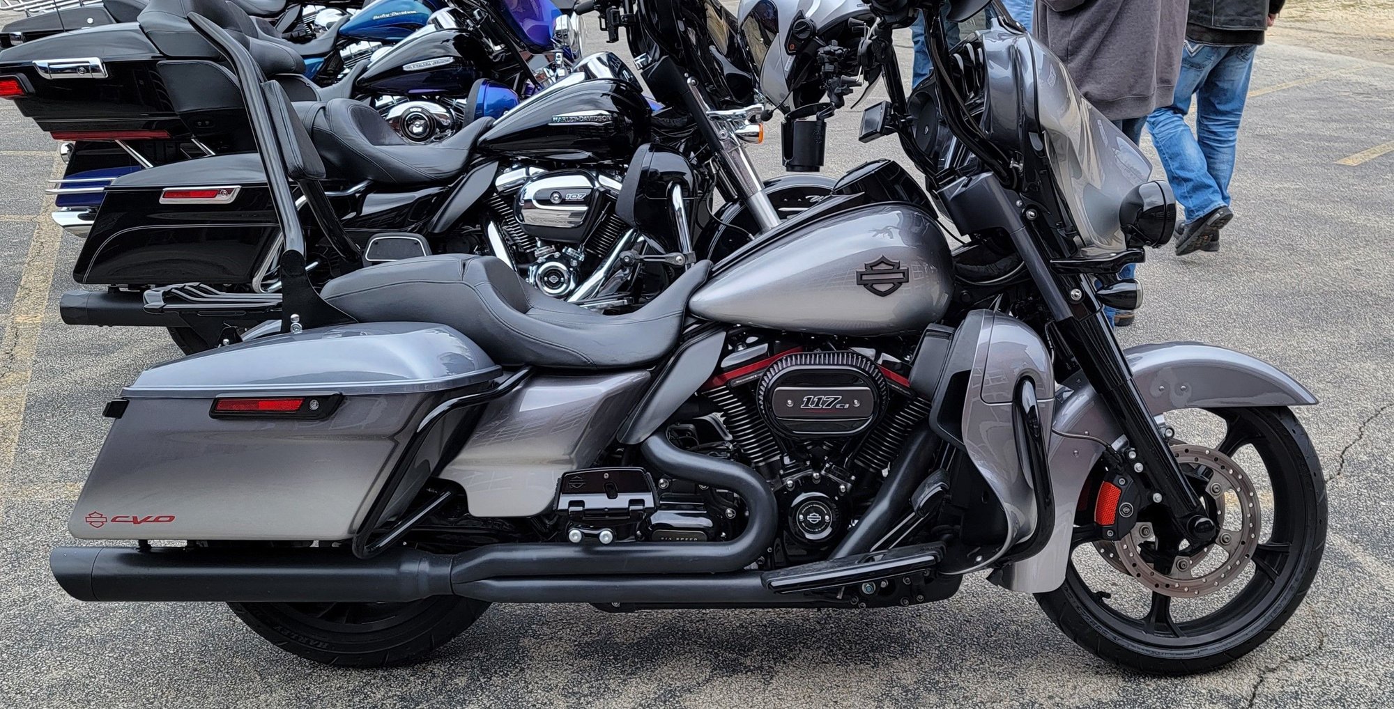

Bought a 2019 CVO Limited in November. Was riding hard a couple of weeks ago and experienced the sumping issue. Long story short, it overheated so decided to get the S&S cam plate and oil pump. Turns out cylinders and pistons were scored as well, sooo.... figured as long as it's down, may as well have some fun with it, Everything listed below is going into it. Picking it up tomorrow. Wish me luck!!
S&S 128 Big Bore
S&S Cycle Billet Tappet Cuffs
S&S Cycle Oil Pump & Cam Plate
Fuel Moto adjustable pushrods
Fuel Moto - K&N Custom Hi Flow Air Cleaner
Wood Performance Directional Alpha series lifters
Koyo Inner Cam Bearings
Zippers RS-548 Cam
Zippers Stage 3.15 heads 10.8:1 CR
• +1.5mm Intake +1mm Exhaust (41.5mm Intake, 33mm Exhaust)
• Competition Valve Job with De-Shrouding for Improved Flow
• Decking to Achieve 92.5cc Combustion Chamber
• Performance High Lift Valve Springs Set Up for Cam
Screamin' Eagle 64m Throttle body and intake manifold
7.1g Fuel Injectors
D and D Billet CAT exhaust
Cycle-Rama Heavy-Duty Compensator
Evolution Industries Terminator Clutch
Rekluse Hydraulic Clutch Slave Cylinder
TTS Tune and Tuner
Trask CheckM8 Vented Transmission Cover
Love Jugs Mighty-Mite Cooling Fans
DK Customs 2" Tank Lift Kit

Great collection of aftermarket parts for sure. Only thing I see missing is the bottom end. If you are going that deep into it, I would do something with the crank.
Good Luck and should be a ripper!

I thought about the bottom end, but S&S and Darkhorse are back-ordered and my wallet was getting thin. As it s, I will only have a week to break it in before I take a trip to the Smokey Mountains, so didn't want to be without it for another month or two.

Good luck on the build. This is such BS that Harley didn’t recall these bikes and make this right. They only had to redesign the oil pump 5-6 times to get it right. I wish they would be sued for this kind of BS. They should have covered it under warranty.

Would love to see which method they bolted your Mighty Mites on with, straight to the engine?
I worry about the lope in my Zippers cam on my 128 just shaking those fans apart!
