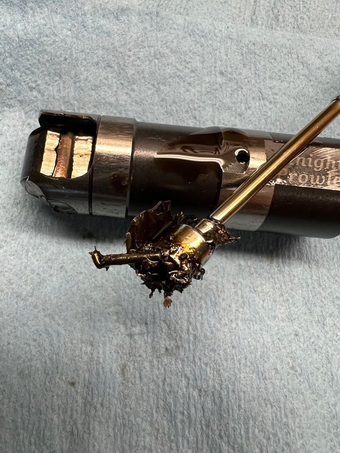

Coming home from Rapid City on my 19 CVO Road glide, I heard one hell of a noise 70 miles from home. Pulled to the side a quick as I could. Damage was done. A friend and I are doing the work, bike has 65K on it and the build has 43K on it.
Roller lifter quit rolling, made no noise. So cam wore though the roller, then it spit the needle bearings and pieces of the roller all through the motor.
You can see cam lobe worn down, and metal. Hoping it was contained in cam chest.

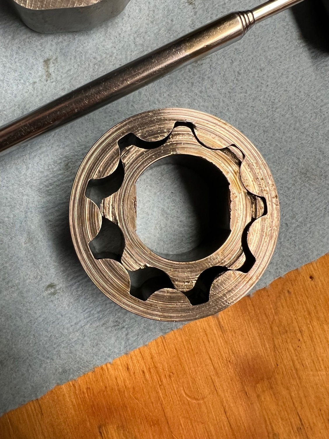

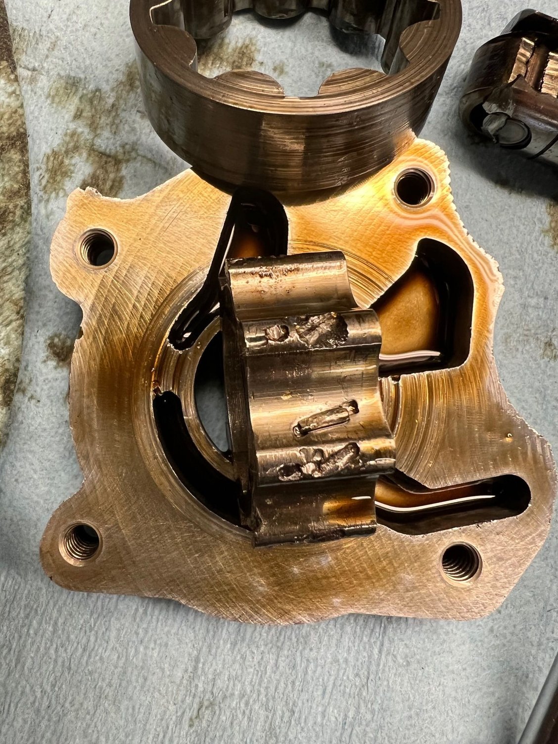

Oil pump jammed together, this is supply side
This is the scavenger side, at this moment we knew everything had to be torn down, not just flushed. You can see were needle bears went though the pump.

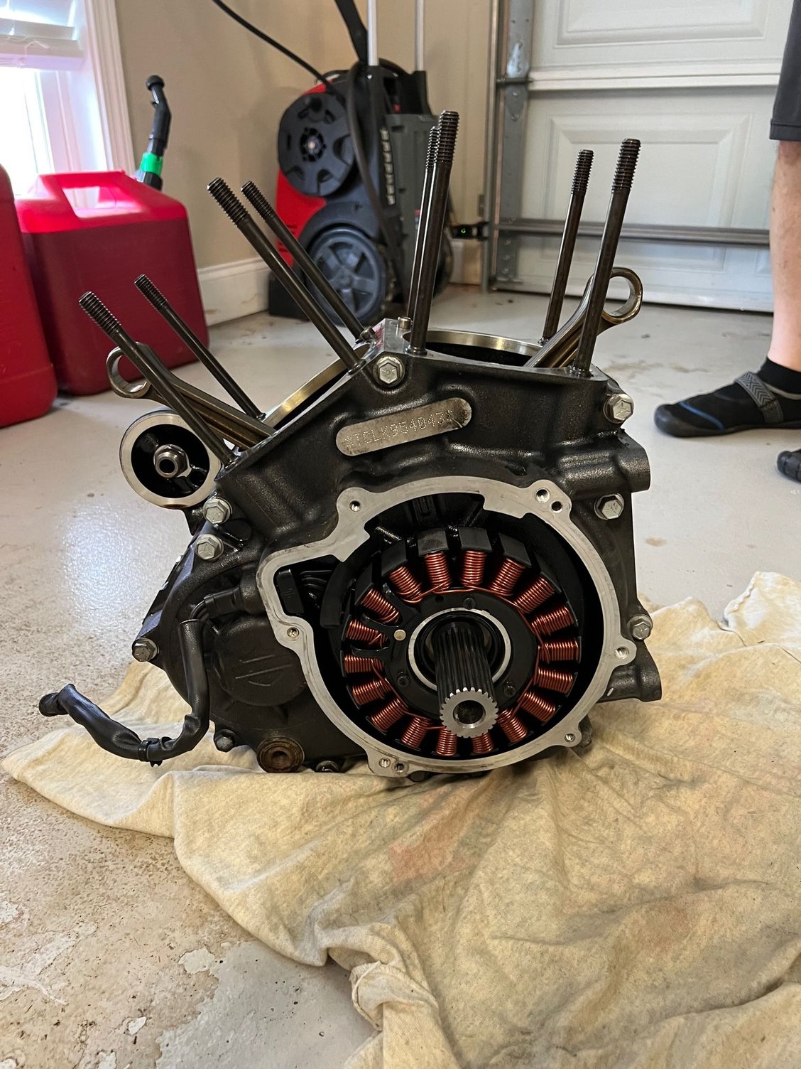

Motor ready to go out to have crank trued, pined and welded. All new bearings installed.
Right side case will also be replaced as there is lifter bore damage.

Yes, woods which made it all the more surprising. They are one of the best lifters you can buy.

Going back the way it was with the exception crank has been trued, and welded and a Cycle Rama heavy duty compensator ramp is going in.
